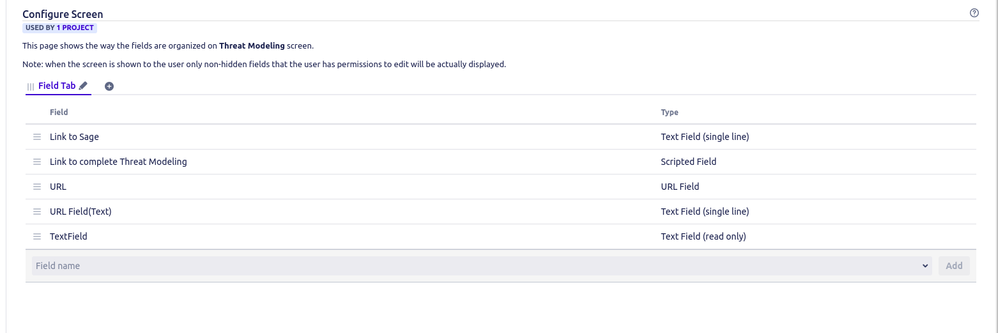

Here is my field

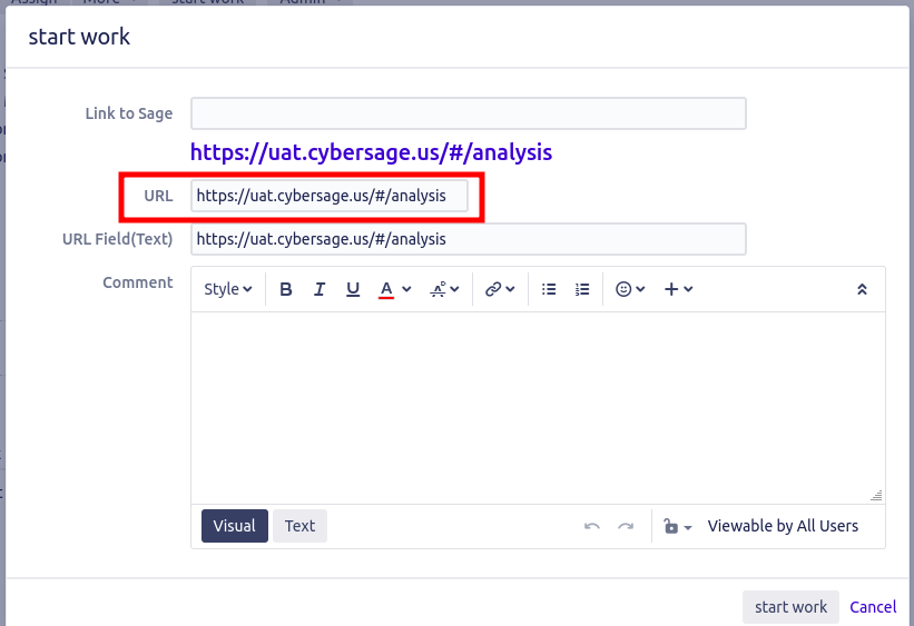

as.pngI am able to set the value to the field but I can not click it. Here is my screen:
How do I make my field clickable? I don't want users to edit this URL. Just want them to click it.

Darryl Lee
December 6, 2022
Ohey @Jamshaid so URL fields are only *clickable* when you are VIEWING a ticket, not in the Transition like your screenshot.
(That screenshot is from Cloud, but Server/DC presents similarly.)
If you are wanting a clickable URL in a transition screen... I think you can do that in a Field Description, so you wouldn't be able to have it change per issue.
Since you are setting the URL with a script, maybe you don't want the URL to be editable at all during transitions? In which case, I would maybe remove it from that transition screen?

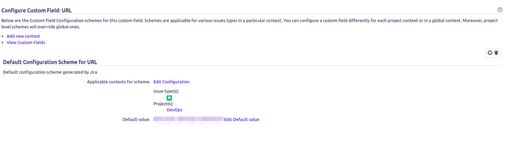

I have tried setting it as default value and it was still editable, due to which I tried adding it using Script thinking of it might make a difference or there might be a programmatical way to do it.
I just want that URL to be added to the URL field and make it clickable. There is no issue in setting it as a default value.
