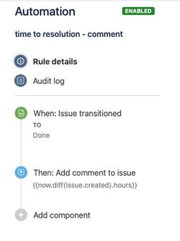

Jack Brickey
May 6, 2020
update: my quick test proved successful. Here is the basic test i did...
Obviously, you will want to adjust the automation and use of custom fields to achieve you precise goal but it does work. I plan to write up an article on this in hopes that it will help others.
