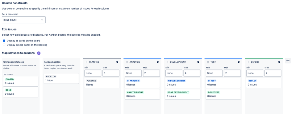

I'm facing a bit of a challenge with my Kanban board setup, and I hope someone can help me out. Here's the breakdown:
Setup:
I have a Kanban board consisting of 6 columns: Hidden backlog, Planned, Analysis, Development, Test, and Deploy. Within three of these columns (Analysis, Development, and Test), tasks can exist in two different states: "In XXX" and "Done XXX".
Problem:
While my workflow is mostly functional, there's a peculiar issue that's been bothering me. Allow me to illustrate with an example:
Let's say I have a task in the "Planned" column. I can seamlessly drag it to "In Analysis" - no problem there. However, when attempting to drag it to "Done Analysis," I encounter a visual obstacle. Unlike the smooth transition I expect, I'm unable to visually drag it to the "Done Analysis" state. Instead, I have to manually open the task and change its state to "Done Analysis" using the dropdown menu.
Question:
Why am I unable to visually drag tasks between these two states within the workflow? Is there a fix for this issue or perhaps a workaround that someone knows of?

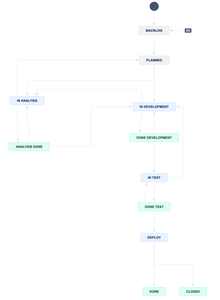

My workflow is as following:
I'd greatly appreciate any insights or solutions you might have on this matter.

Are you saying that you can transition from Planned into Analysis Done directly on the issue, but not from the Kanban board?
If so, that seems very strange, as I don't see a transition from Planned into Analysis Done, so I'm not sure how you could do it from the issue.

At the moment my columns and statuses setup in Jira are as this:

Unfortunately, this is expected behavior. If the two statuses exist in the same column on the board (which it sounds like "In Analysis" and "Analyis Done" do on your board), then you can't transition between the two statuses on the board. Transitions are only allowed on the board if the source and target statuses are mapped to different columns.

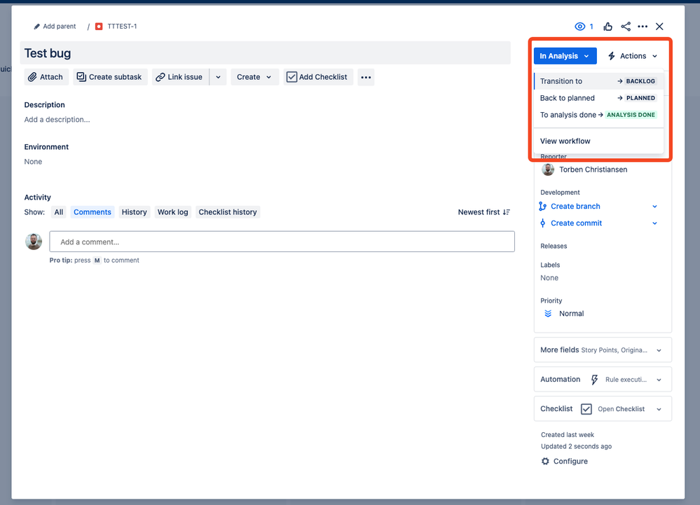

But just so I fully understands; I can still make a task transfer from "In Analysis" to "Analysis done" when open the task right?
Like this:
Matt Parks
May 14, 2024
Yeah, as long as the transition is allowed in the workflow and you meet all of the conditions (if any) on the transition, you can always transition the work item.
