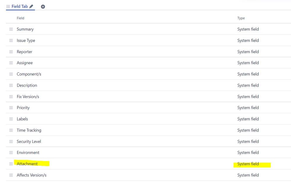

1. Noticed under Administration  > Fields > Custom fields, that those newly-created attachments fields have a info notice "This custom field stores its data in a non-standard way, that's why we can't show accurate data about its values or issues using it.".  So one cannot filter for issues with (or without) any attachments.  Correct?
2. How could one not hide (or remove) the standard Attachments field show in the main content of an issue, or is that not possible?

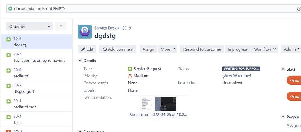

1- Yes, you can filter issues with or without attachments, using IS EMPTY or NOT EMPTY in your JQL:
2- Yes, you can do that by updating your issue screen
