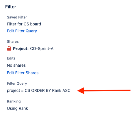

If so, what is the Filter Query details for your "general Board"? You would find that by clicking the ... button in the upper right corner of the board, then select Board Settings, then General. The filter query details will be part of the information on the General screen.
Example:
An issue will display in a board (the Backlog view or Board view) only if the issue is within the scope of the Filter Query for that board.
If you want one board from which you can manage all the issues in your 10+ projects, the Filter Query for that board has to be structured so that it includes all those projects.

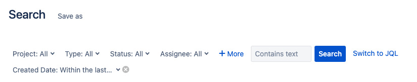

From the General settings of your board you can click on the "Edit Filter Query" link (shown near the top of the image I provided). That will take you to the Issue Search screen where you can edit the filter and save it. Once edited and saved, the board will automatically use the changed filter.
To get multiple projects included in your filter there are a couple of ways to do that depending on whether you see the Basic Search interface...
...or the JQL search interface
You can switch between these interfaces using the "Switch to JQL / Switch to Basic" link to the right of the Search button.

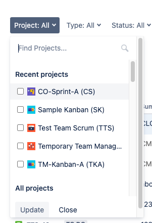

In the Basic interface you would pull down the Project list and check the boxes for all the projects you want to include. Then click the Update button at the bottom of the pop-up.
