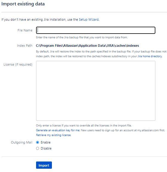

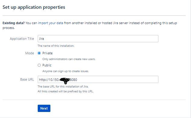

When starting Jira up I am now getting the Jira setup page  . If I select import Data its asking me for a file location .
How do I get Jira not to want to set up , but to use the new DB that was populated with prod data ?

Jira will do this if it is connected to an empty database.
First thing to check is if the new database really does have all your old jira data in it and is readable by the user set up for it.
