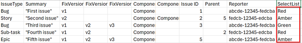

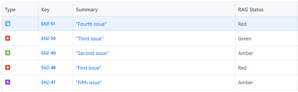

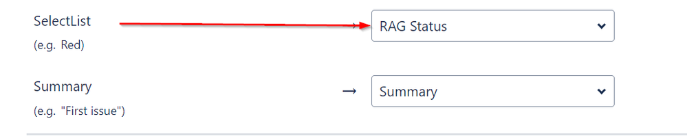

If its a select list field you should be able to import values from CSV too. Refer below sample CSV I tried to import in my project, I mapped the column "SelectList" from my CSV to "RAG Status" Jira field (select list having Red, Amber Green values) and it worked as expected.
CSV -
Mapping -
Jira Issues -
