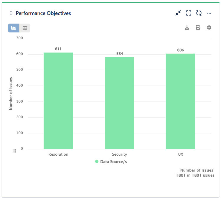

In Performance objectives app you can define 2 (or more) data sources - as per your example one data source for Project CF and label US (label is defined in JQL), another data source for Project CF and label OUS. Then you can display data on a bar chart 'by Data Source'
Here is an example of the visualization for that kind of configuration. 'Resolution', 'Security' and 'UX' are Labels in Project 'X', defined as 3 separate data sources in the 'Performance Objectives' dashboard gadget (3 Labels of many).

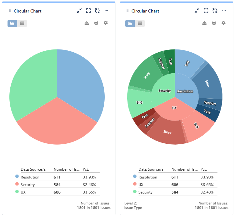

You can also use the Circular Chart gadget in the app and visualize your data on a pie chart. There you can add 2 more levels of hierarchical data using any other Field or Metric available in the app, for example add Issue Type as Level 2, as shown on the right chart:
The chart is interactive and you can click on any of the inner elements to drill down and inspect the data in more detail.

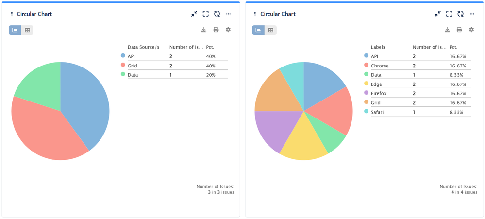

Below is a simple example of the difference between displaying data 'By Data Sources' and displaying data 'By Labels' in the app.

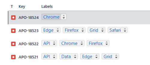

These are the test issues with their labels for both configurations:

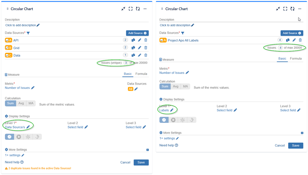

And below are the results. Chart 1 is configured with 3 data sources, each filtering 1 label (API, Grid, Data) and displaying data by data sources. Chart 2 is configured with 1 data source (all issues) and displaying data 'by Label':
Here is the configuration screen showing the display settings for both charts:
So this issue APO-18524 with Label Chrome is not included in the first chart. Issues with more than one matching Label are counted separately in each segment.
Multiple data sources in the first configuration allow you to segment and display data only for these particular labels.

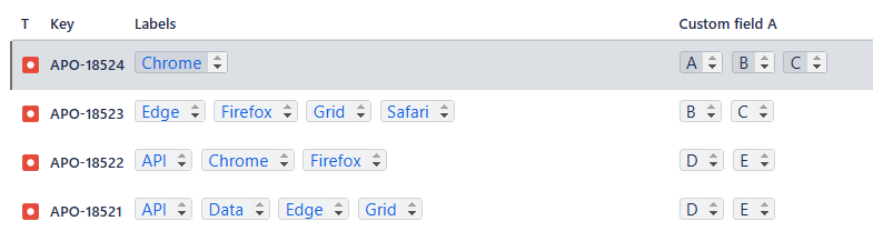

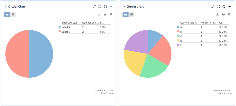

I've created a 'Custom field A' as per your example, and values A, B, C, D, E for the same set of issues, please check:
Issues included:
Configuration screen for the data source:
Results:
In my answer I was using native Jira 'Labels' to give an example of the visualization, but I described that custom labels can be filtered in JQL.
