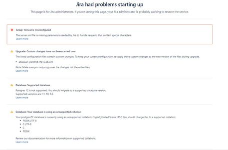

I got this result when I run it through https. I did roll back to http on order for it to work.
I'm not sure if my issue is with the certificate or something else.

The error message here is clear - you have not made the changes required in server.xml.  Take another look at that file.
For what it's worth, most people who ignore that part of the doc either don't read the bit about commenting and un-commenting the right section, or they don't read the bit about the port number and pick a random one mentioned elsewhere in the file because it's a number.

If I am reading it correctly, your server.xml has a commented-out connector for plain http, and an enabled one for https.  The http connector includes two directives that start with "relaxed", but the https one does not.
I think you want to add those two directives to the https connector

It work now after adding missing lines in the HTTPS.
