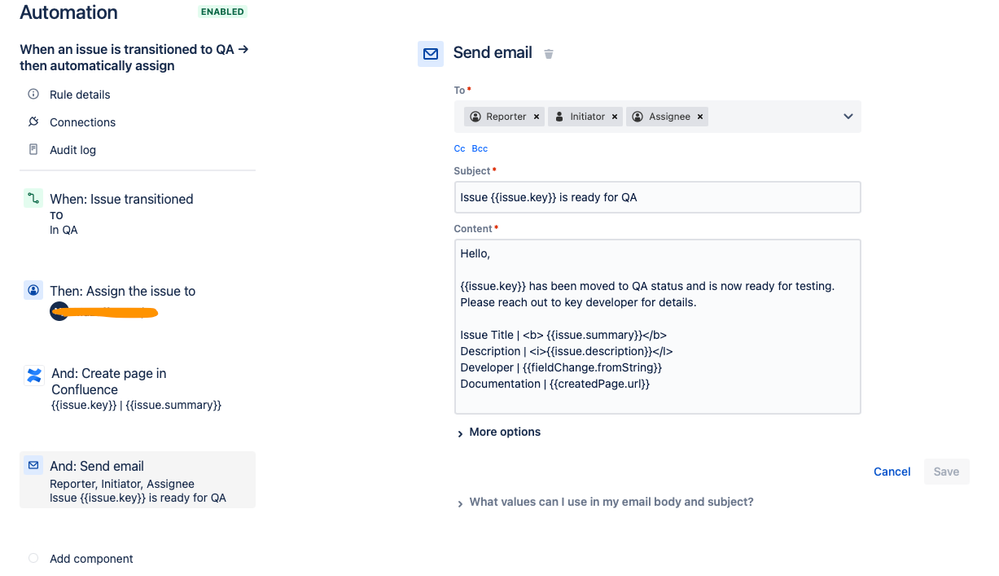

Hey all,
I've been wracking my brain trying to reference these within the body of the email but they keep coming up blank. I am using the following smart values but nothing seems to work:
Hello,
{{issue.key}} has been moved to QA status and is now ready for testing. Please reach out to key developer for details.
Issue Title | <b> {{issue.summary}}</b>
Description | <i>{{issue.description}}</I>
Developer | {{fieldChange.fromString}}
Documentation | {{createdPage.url}}
The issue title and description work perfectly but the last two, Developer and Documentation, don't seem to want to work.
any help appreciated.

When issue transitioned to "QA" > assign to X > email (the body was attached the original question above) > create page
I just now realized that I need to create the page before referring to it in the email body so that's solved but I still can't seem to get it to display the previous assignee no matter how I try it.

Appreciate the response. Heres a screencap, is this sufficient? Thanks!

What are you expecting the fieldChange.fromString to be?
Geoff Worling
October 17, 2022
Hi Simmo,
As far as I understood it, it would reference the changed field in the issue. In this case, the assignee. So it would display the previous assignee.
Bill Sheboy
October 17, 2022
Hi @Geoff Worling
The change log smart values, {{fieldChange}} and {{changelog}} refer to any issue changes relative to the trigger issue.  Your trigger is on Issue Transitioned, so they would only refer to the status values.
If you need to refer to the previous assignee, as they change over time and for other trigger conditions, you would need to either save that value in a custom field when the Issue Assigned trigger fires or create a more complex rule which calls the REST API to extract the last assignee.

Simmo
October 17, 2022
Pretty much what @Bill Sheboy said :)
Though, if the assignee was changed as part of the transition, it might be available in the changelog.

Geoff Worling
October 17, 2022
I used this guide from Jira itself so I guess this is where my confusion started...
Jira Smart Values - Issues
Where it states the following example, which is exactly what I'm trying to do:
"{{fieldChange}}
Available anywhere smart values are supported, to access the value of a field that has changed. For example, if the Assignee of a field changes, you could add a comment to the issue to note who the previous assignee was, and who the new assignee is."

Simmo
October 18, 2022
Ah yeah, I can see that being a little confusing. As @Bill Sheboy said, the fieldChange is in relation to the trigger.
