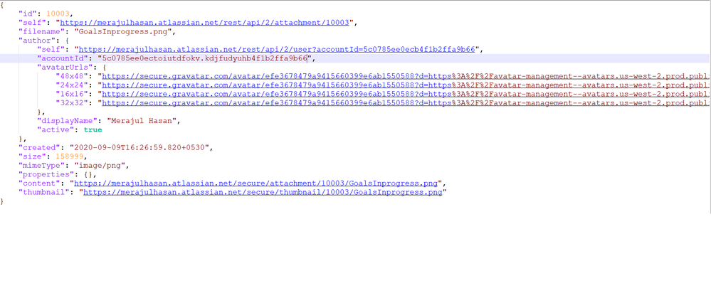

Merajul Hasan
September 13, 2020
Hi Angelich,
Jira does not provide directly the content of the attachment but the secure URLs of the attachments.
Here my colleague @RishabhT  is concerned with the contents of the attachment.
The createmeta request working fine but returning only URLs perhaps we need file actual content in the form of base64/blob of the attachment.
So, Is there a way to fetch the content of the attachment ?
We are getting following response currently.
Angélica Luz
September 15, 2020
Hello @Merajul Hasan,
Thank you for the details.
I'm afraid this is not possible using API. Blob is recorded in the database which can't be accessed in Jira Cloud.
The only APIs available are the ones from the documentation and none of them returns what you need.
Also, I didn't find any feature request suggesting this ability, so please, feel free to raise one on jira.atlassian.com (project JRACLOUD) adding more details about why this feature is important for your environment.
