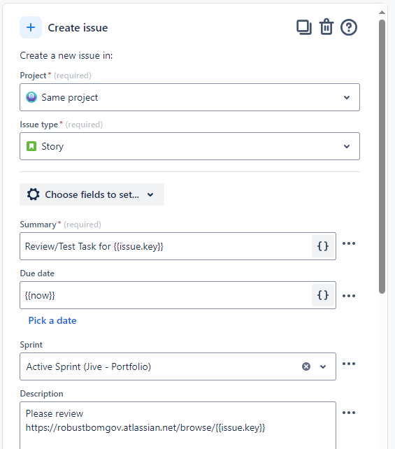

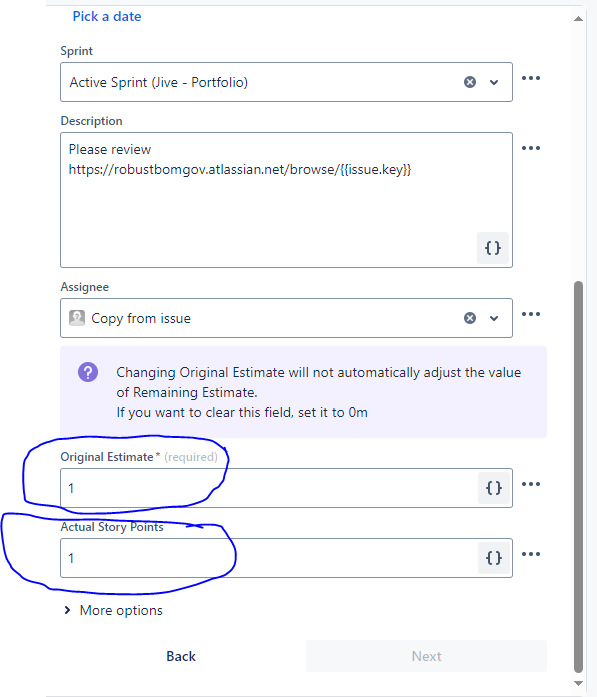

I have created a Task Creation Automation that when a story transitions from In Progress to In Review I want Jira to create a new story and assign that new story 1 story point.
The story creation works fine but for the life of me I cannot get the automation to assign 1 story point to the new story. The new story is created fine but the points are not set.
How does this need to be coded?
You can see in the picture below on the right, I have set Original Estimate to 1 in the box and Actual Story Points to 1 as well but when the story is created, no estimate is set. This is so not obvious. I don't know if I need to put 1 in the box or {1} or some other format.
Any help would be appreciated.

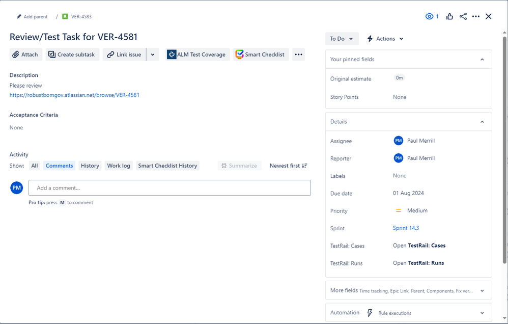

Here's an example of the task created.
The TYPE information says Company-managed software.
If I open the new story created by the automation in Jira I can go to Story Points and put in 1 and then close and it works fine. What I'm trying to do is set Story Points to 1 from the Automation.

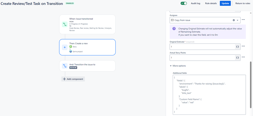

Perhaps let me explain differently. I have an automation that has two steps. The first is when an issue transitions from In Progress to Review, then I want an automation to create a new story. This part does work. In the Then: Create a new story in the same project I can see on the right hand side:
I've added in the rule Original Estimate and Actual Story Points and set them to 1.
Now for some reason, the new task is created correctly, except the Original Estimate and Actual Story Points in the new task created are blank.

Under the More options there is an additional fields section that has a bunch of text in it (see below). Am I correct if I say that I need to put "code" in this section to set story points of the new task I'm creating, perhaps something like, {"Story Points": {1}}
Here's the text in the additional fields section I can see:
"fields": {
"environment": "Thanks for raising {{issue.key}}.",
"labels": [
"bugfix",
"blitz_test"
"Custom Field Name": {
"value": "red"

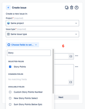

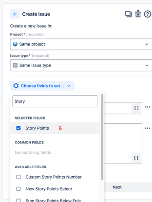

To set the Story Points field in your Create Issue action:

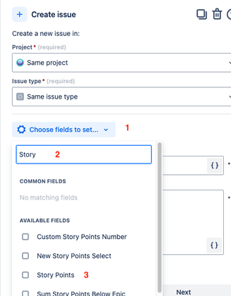

1. Click the Choose fields to set... button
2. Type Story into the search field. This should reduce the field list to a set that includes Story Points (3)

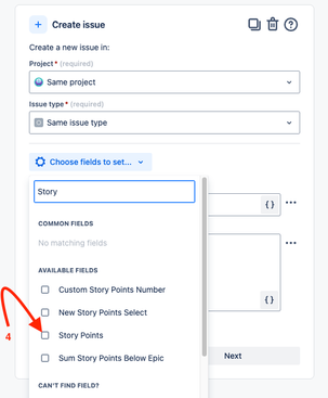

4. Check the box next to the Story Points field that should be displayed in the result set.
5. This should move the field to the Selected Fields section at the top of the pop-up with the box checked.

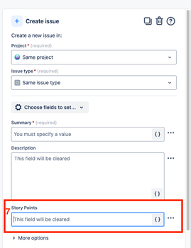

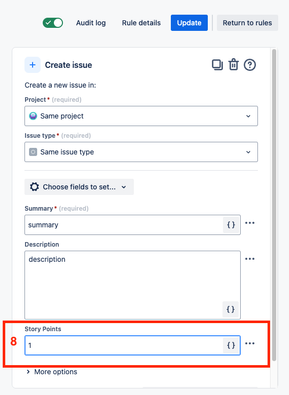

6. Click somewhere in the white space of the Create Issue dialog outside of that field selection box.
7. That should make the field selection box close and you should see the Story Points field displayed in the Create Issue dialog.
8. Type a 1 into the entry field below Story Points
9. Click the Update button above the Create Issue action dialog to save the change to your rule.
10. Execute the actions that cause the rule to run.
11. Review the new issue created. The Story Points field should show a "1" in it.

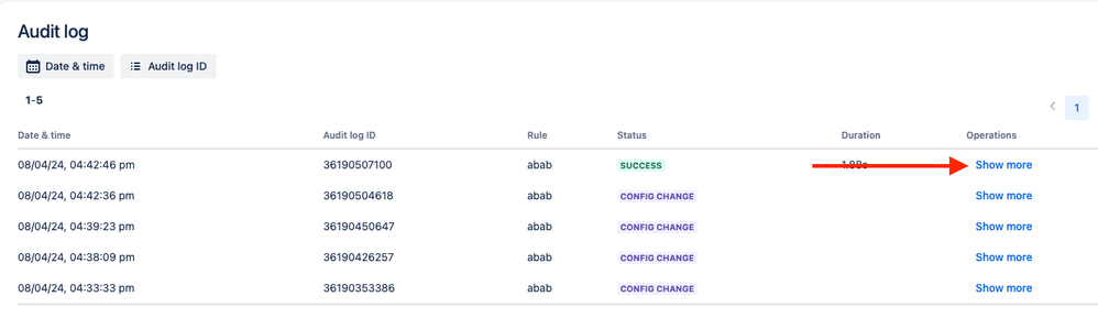

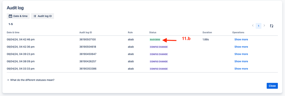

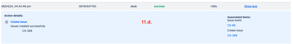

11. Provide the output from the rule execution Audit Log.

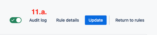

11.a. Find the link to the rule's Audit Log summary page in the upper right corner, above where you enter the details for the rule steps. Click that button.
11.b. The Audit log screen will display. That screen will show a list of time stamped entries for each change you made to the rule and for each time the rule executed. Find the entry that coincides with when you triggered the rule. Note that this should have a status like Success, or Some Errors, or Failed. The ones that say Config Changed are from when you made changes and saved the rule.
11.c. Click the Show More link to the right of that entry.
11.d.  That will show the log details for that one execution. Provide a screen image of the details.

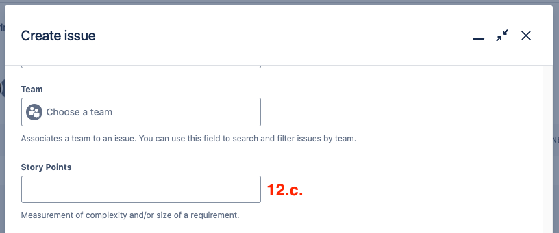

12. Lastly, rather than trying to manually edit the field in an issue created by the rule try manually creating such an issue from scratch.
12.a. Click the Create button.
12.b. Select the same Project and Issue Type referenced in the rule.
12.c. Do you find the Story Points field in that dialog?
12.d. Enter a value in that field, complete all other required fields, and save the issue. Then review that newly created issue and confirm that the Story Points field has the value you entered.

Trudy, many thanks this worked fine. The new story is created with an effort of 1.
