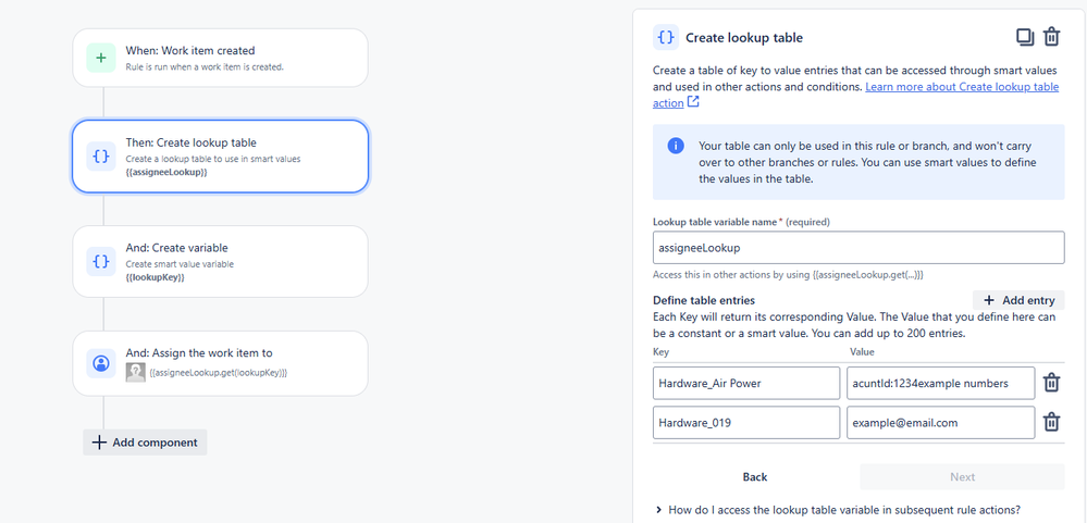

I am using a lookup table by having Department and Class be the key then having account Id be the value.

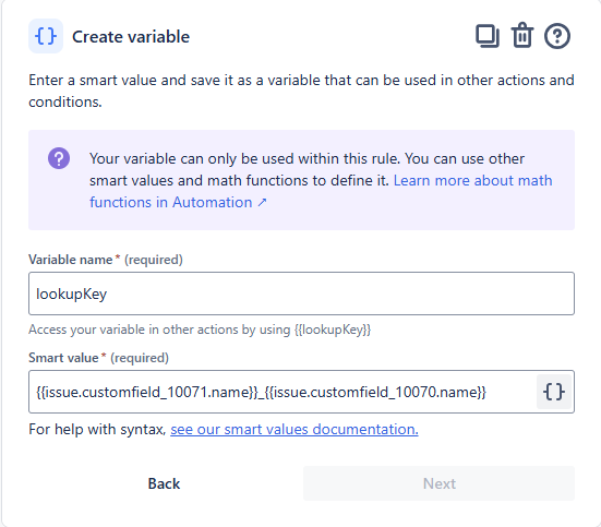

Then I create a variable that holds the Key to the lookup Table.

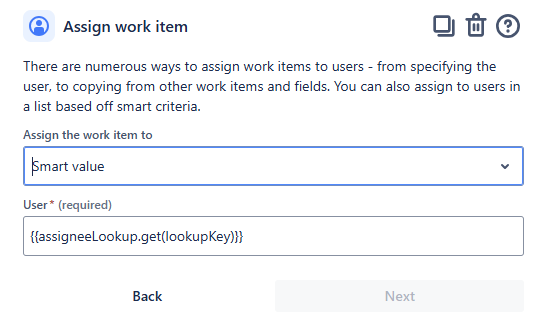

Finally I use the key to get the person I want to assign the issue to
The issue is that for some reason it says specified user does not exist or you do not have required permissions. When I log it shows the Key as Hardware_Air Power and for the value I have tried accountID, email, and username.

1. Format of the value
The "Assign issue" action expects the accountId format. If you're feeding in email or username, it will fail (especially in Cloud where usernames are deprecated). Make sure the value stored in the lookup table is the raw accountId — looks like this:
5b10a2844c20165700ede21g
Double-check that you're not wrapping the value in quotes or extra formatting.

Sometimes the key resolves correctly (like Hardware_Air Power), but the lookup fails silently or returns null. Add a log action to see what’s coming back: Log action: Assigning to → {{lookupIssues.get(lookupKey)}}
Make sure you're referencing the right smart value inside your Assign issue action: {{lookupIssues.get(lookupKey)}}
