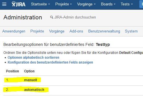

we try to evaluate XRAY for JIRA Server (7.3.5).
The first installation was started from the UPM. We start a test project with sample data from Jira. After installing XRAY and assigning to the project, I wasn't able to create a TEST. I always get the message "testtype does not exist"
Serval tries later, i decided to reinstall again, because there was no testtype "manual. automatic or generic" installed. Installation from the ZIP-File produces the same effect.
After creating an option "manuell" and "automatisch" on the user defined field testtype, XRAY regonized this testtype in a report as "other" type.
Defined option for "testtype":
XRAY-Report:
The defined testtype from XRAY are not available in my installation. Something went wrong in my insatalltion. Do you have any idea, which solves my problem ?

Default Test Type value options are;
  • Manual
  • Cucumber
  • Generic
Try to add missing values, they can also be case sensitive.
But as a first installation they should be present on Xray Default Test Screen and Test Type

Hey Mesut,
case sensitive , that's the reason. I added the missing values in a case sensitive form.
now it works as designed.
