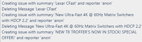

I'm trying to create a mail handler that creates tickets when an email is sent to a specific email address.  I've been following the instructions here: https://confluence.atlassian.com/jira064/creating-issues-and-comments-from-email-720412438.html
From what I can tell, everything is set up correctly, and when I 'Test' is shows the test was successful.  When looking at the details, it shows 346 messages were read from the server at 10 issues were created.  However, when you look in the details further, it also shows that not only was an issue created, a message was deleted.
Is the test supposed to create real issues/tickets? Because it is not.
In addition, when I send a test email to the email specified, no ticket is created.
What am I missing and/or how can I troubleshoot this?
Mindy Bollinger
May 23, 2018
My test log works:
However, is it really supposed to create an issue? Because it is not.
I've also sent several test emails to the email address (set up in the servers) - but have not seen anything being created or done.

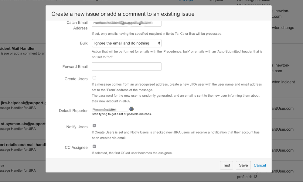

Can you share (using some screenshots etc.) the mail handler configuration as well as the permission scheme in use of the project?
BR
Kurt
Mindy Bollinger
May 24, 2018
We're just going to use the default jira email that came as a default - for now. That is working fine, and is creating tickets as needed, when emails are sent to it.
