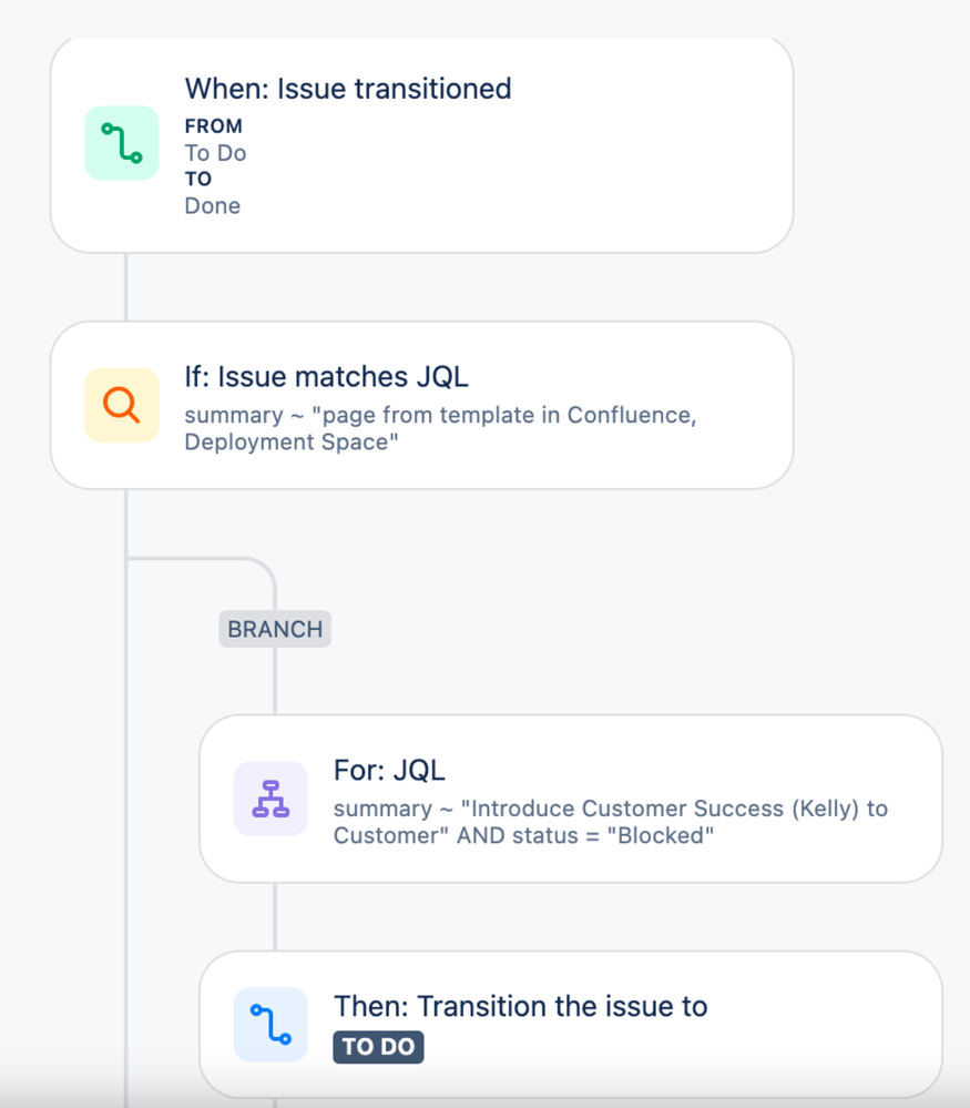

Hey @Bill Sheboy @Walter Buggenhout I wonder what you think about this if you have the time:
So just to reiterate, I'm building a rule that changes the status of a subtask whenever the status of another subtask changes. Here's the code, but the problem is that there will be multiple subtasks matching the issue summary, since there will be one per task, so I wonder whether you have ideas on how to check whether these 2 subtasks belong to the same parent or task.

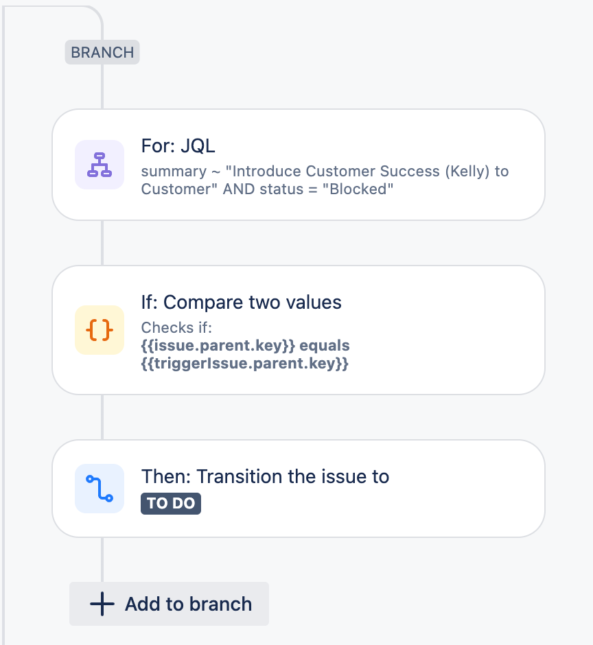

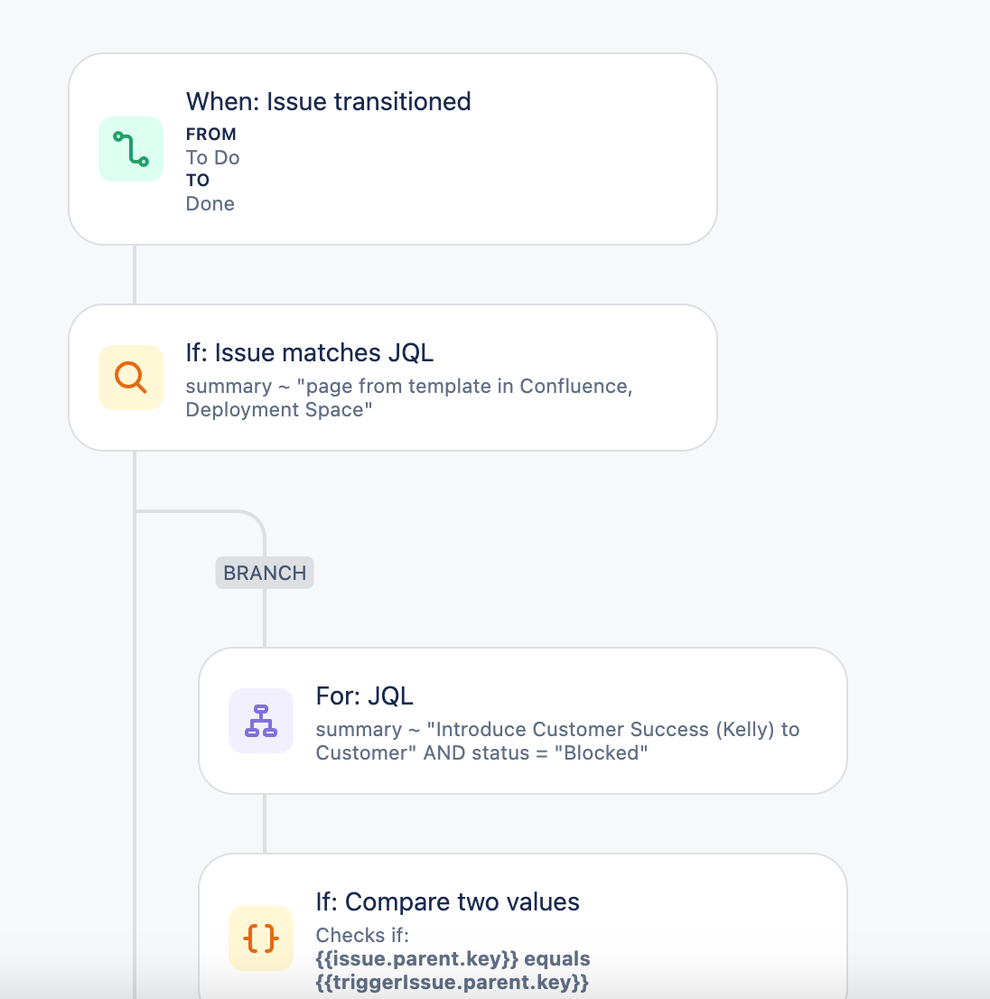

Martina
February 14, 2024
@Bill Sheboy BTW, I was able to fix it, thank you so much!
Attaching the code in case you're interestedScreenshot 2024-02-15 at 00.31.10.pngScreenshot 2024-02-15 at 00.31.24.png

Bill Sheboy
February 15, 2024
I am glad you got something to work!
Although it is curious adding that expression to the JQL branch did not work, showing "field 'parent' is invalid."  It would have been valuable to see both the actual branch and the audit log for that case, as I tested it before I posted the suggestion.
