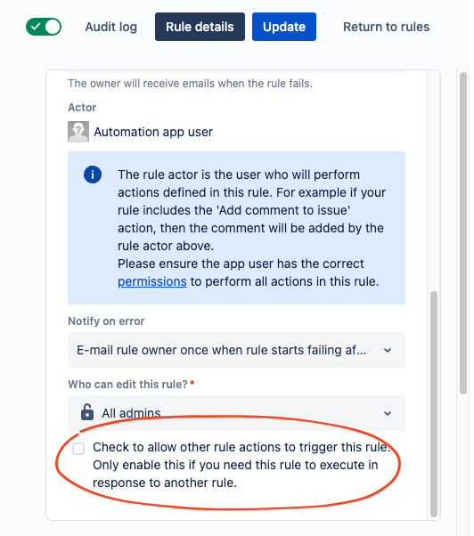

Have you tested switching on this possibility on your rules?
So this ^ setting would allow for the rules to 'hear' and be called by triggers from other rules. Please give this a go and share your feedback.

Hi @Valerie Knapp ,
yes I have that activated already.

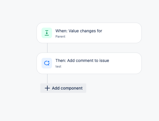

Hi @Niklas Malmberg ,
I got this to work
Can you test / try something similar?

Hi @Valerie Knapp,
I just tried to create a rule like that, and then simply moved a subtask from one story to another. But the new rule was not triggered at all :(

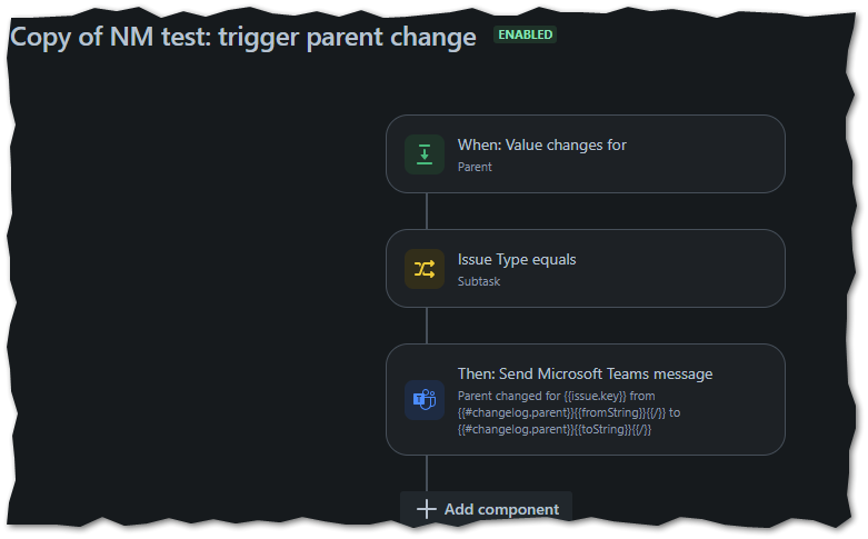

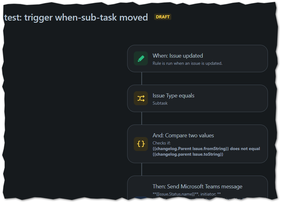

I did a test, tried to follow the suggestion found here: https://confluence.atlassian.com/jirakb/how-to-run-an-automation-for-jira-rule-when-a-sub-tasks-parent-changes-moved-1123194416.html
Unsure about different Jira version so not everything was 100%, my rule looked like this
However, for me this rule did not trigger at all on a Subtask move (=change parent) between two Stories in the same project
Does anyone have another suggestion how to detect such an event?

That post is for Jira Server / Data Center, which has different fields in some cases...like for parent apparently.

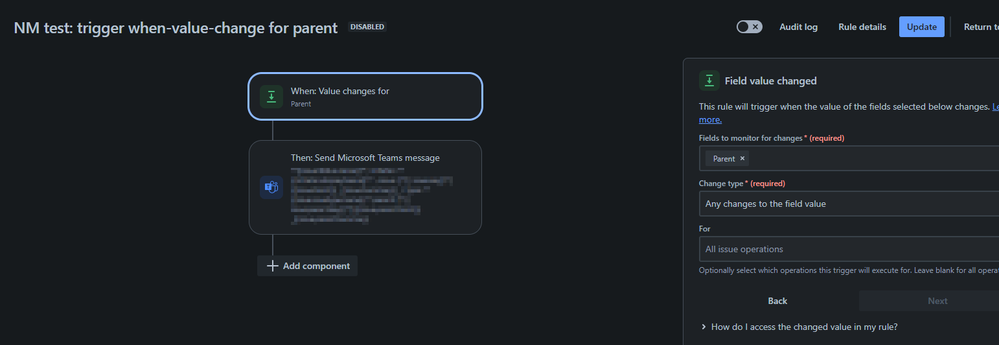

First off, the reason my rule did not trigger at all before was starring in my face, and it's even visible in the first screenshot I posted - the rule was Disabled (*sheep*)
(and the reason for that was malformed smart values in my message part. Once corrected I did get the rule to fire as I wanted)
So Yes, trigger suggestion from @Valerie Knapp is working just fine, Value change for the parent.
Furthermore, both" equals" and "is one of" both work for me when comparing with Subtasks.
On the issue that is triggered, new parent information is available, great.
I can retrieve {{issue.parent.key}} and {{issue.parent.Summary}} for example

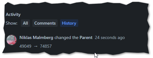

What I can see in Jira is that the History of the issue logs the change of parenthood, I'm just not able to access this yet.

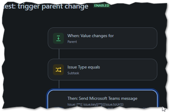

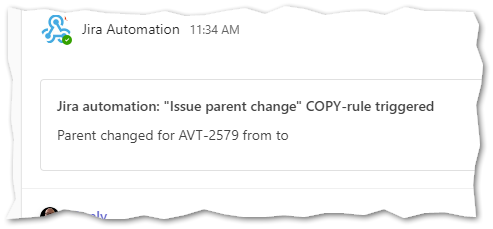

I created a fresh copy of the rule, stripping out everything extra (and turned off the old rule). Now the new rule is just this:
Still, I get output from {{issue.key}} only, no output from changelog-statements,
Is that some feature that needs to be enabled per project perhaps?

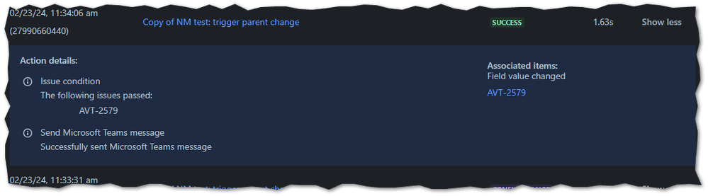

The audit log shows that my subtask "AVT-2579" triggered the rule and that it ran successfully.

Ah...are you using a Company-managed or a Team-managed project?  You may find that information at the bottom of the left-side screen expanding area.
If this is Team-managed...
It appears the changelog does not work for that field.  (Seems like a defect to me.)  The closest I was able to get was using {{fieldChange}} and that only provided the issue id, and not the key:
parent changed for {{issue.key}} from {{fieldChange.fromString}} to {{fieldChange.toString}}
But...we can use that to find the actual key with a lookup issues action:
  • action: lookup issues, with JQL of
    • id = {{fieldChange.fromString}}
  • action: log the change, with
    • parent changed for {{issue.key}} from {{lookupIssues.first.key}} to {{issue.parent.key}}

Good guess - Yes, I'm running Team-managed in this project.
It works well with fieldChange, so now I have access to both previous and current parent keys, GREAT!
