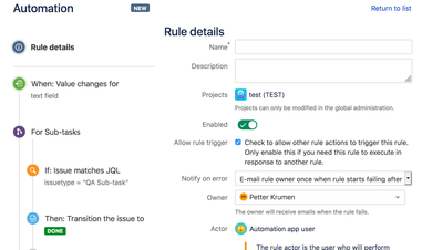

3 - Finally, you must navigate to the second rule (Rule Details) you created and allow it to be triggered by another rule:

Thank you, Petter, for that good suggestion. By a very strange coincidence, I implemented the exact same idea a few days ago. However, I found that, for some strange reason, it doesn't work. When I complete the Dev task, the first rule fires and completes successfully according to the Audit Log. It says that the new custom field was edited successfully. But, the second rule doesn't seem to get triggered at all. So, I wrote a small Python script to get the value of the new custom field from the parent story and found that the field doesn't seem to have been set at all. I'm not sure how I can troubleshoot/debug what's happening or what is causing the field to be not set in the parent story even though the first rule is apparently successful. Thanks in advance for any further help/pointers you can provide.
