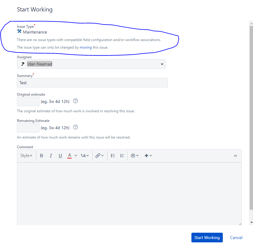

Hi All,
I've made a transition screen (different that the create issue screen) and for some reason i get a notification that i dont understand, can someone explain?

Nic Brough -Adaptavist-
August 29, 2021
This means you have put the issue type "field" on a transition screen, but there are no issue types in this project with the same configuration as the current issue type.
In other words, it's telling you why the issue type "field" is not listing any options
Idan Naamad
August 29, 2021
You are correct, it worked.
Thanks a lot to you both!!
Mohamed Adel
August 29, 2021
Hi @Idan Naamad
Did you change the issue configuration scheme/ screen scheme ? I can understand that some fields are no longer relevant to that issue type.
can you check and confirm.please?
Thanks in advance
