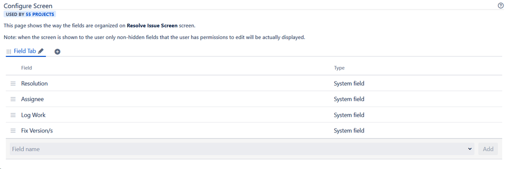

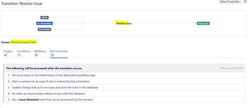

The setup is a workflow where on "resolve" transition a screen is in place. This screen has the system field "resolution" on it.
That means: every user that is to execute the resolve transition is asked for a resolution - this works for many years, all good.
The screen, in my opinion, looks great as well:

Resolution field is default Jira field and it always is required when it appear on screen via GUI and it won't be required via rest api because making tranistion via REST API don't respect screens.
Only workaround what I see is set validator on tranistion with resolution field. Via GUI it will be "double required" but user will not see this. Via REST API user will get error that resolution is required.
