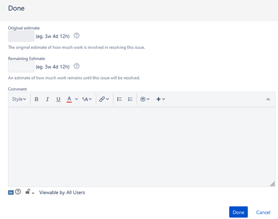

I need to add a transition screen where the user is able to set the time spent and the time remaining. I do not why but the time spent does not show. I have set a simplified scenario to make some tests but I have not been able to succeed.

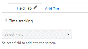

1.- I have created a new window with only the time tracking field.
2.- I am using the default flow adding my screen to the default flow

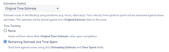

3.- I have configured the project to use Original Time Estimate and time tracking using Remaining Estimate and Time Spent

When the transition screen appears only the original estimate and Remaining Estimate is shown.

Hi @Lluís Barbal
In your case you should add "Log work" field on the screen instead of time tracking.

Hi @Lluís Barbal , thanks for your question.
Do you mean that you want to be able to see the hours worked? For this, you would also need to add the 'Log work' field to the screen. Time tracking show, as you see, the estimates and their current state, but to be able to reduce the Remaining Estimate with the time you have spent, you need to add the 'Log work' to this screen.
