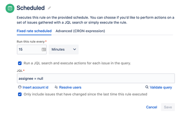

How about trying this.  Use a scheduled trigger and use a jql for "assignee = null".
You could have it run more often that I have set in this screenshot, but it should do what you want?  You can make the jql more complex if you want just specific projects or other criteria.
