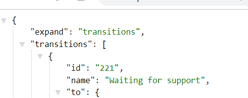

The transition exists and when I go to the postUrl I can see it:
Any help would be appreciated!

Hi @Fabio Racobaldo _Catworkx_
Thanks for your response :)
I think that's what I'm doing? This is the code that I'm passing to it. Is this id the correct one? I'd assumed from the screenshot that I included that because it as top level it was the correct id to reference, but maybe not!
string example = @"{
""id"": ""221""
}";I then convert it to json and pass it to the post:
string ticketjson = JsonConvert.SerializeObject(example);
