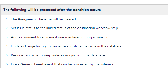

when I tried to move task to different state in my workflow, I got error saying "Transition failed, Internal server error". It is happening only for few states, not all.  I've checked transition settings and post function and didn't find anything wrong.
Can you advise me what can I do or look for?

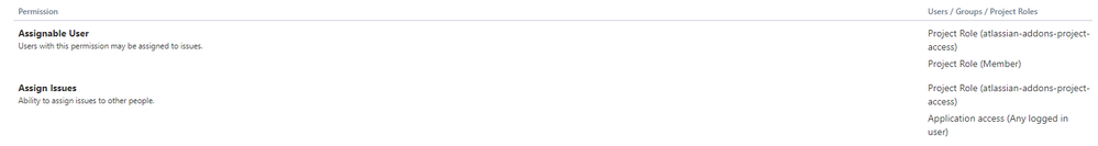

I have permissions for this project set like this:
Seems ok to me. Anyway when I deleted first post function rule, it is working but that rule was helpful and team wants it back. So do you think the permission on screenshot are wrong?

Ok, so the permissions all look fine, and "any logged in user" can assign issues, so it's not that.
The only thing left in my theory is to check that the user you are trying to assign the issue to is in the role of "member" in the project?

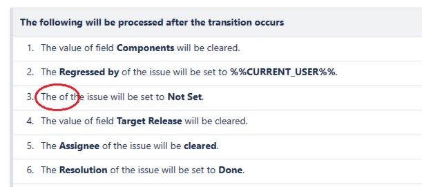

Just in case anyone else comes to this forum looking for answers to the illusive:
For us, I eventually managed to spot the issue was caused after deleting a Custom Field, and how badly Jira's Post-Functions handles this:
So I simply just removed the broken post-function (step 3) and problem solved!

Hi @kristyna.ludwigova,
The only thing on this list of post functions that may ring a bell is the first one: do make sure that all users transitioning issues in your project also have the assign issues permission. Apart from that, there is nothing apparently suspicious in your configuration here.
