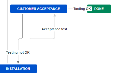

Does any one know how i can update the jira screen in a correct way after transition with a goory script.
My script (below) works if i run it from the scriptrunner console and preparing the issue to be in the right position for the transition i would like to do, then the issue looks as it should. after i have ran the script.
But when i run a similar script from the script listener, Fires an event when condition is true.

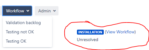

The issue is transitioned to the right status, but the status value is not changed.
How can i update the issue screen after the transition is done in a correct way with the script?

Thanks,  unfortunatly i get the same result as befor, the transition values is ok.
But the status for transittion should be "customer acceptance" and is not correct and does not change after refresh
