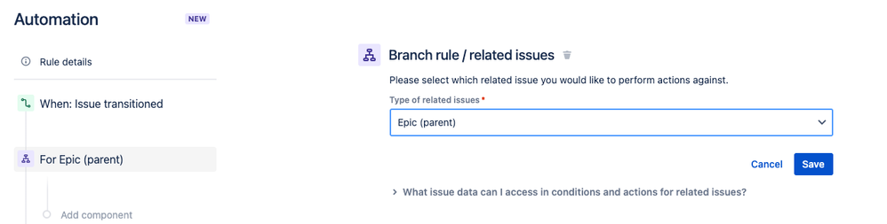

To get to the parent issue you would either use the Branch / Related Issue as shown below...

I've tried that Branch style and it only works on Epics. Not on the issue that is linked via the "Parent Link".
