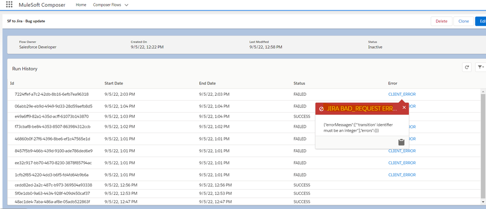

We are using salesforce to Jira integration and using mulesoft as a integration tool. but facing below error in Jira
{"errorMessages":["'transition' identifier must be an integer"],"errors":{}}

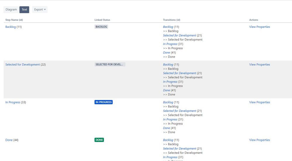

Can you show how it's configured? You need to enter the ID of the transition
https://community.atlassian.com/t5/Jira-questions/How-to-fine-transition-ID-of-JIRA/qaq-p/1207483 something ismilar

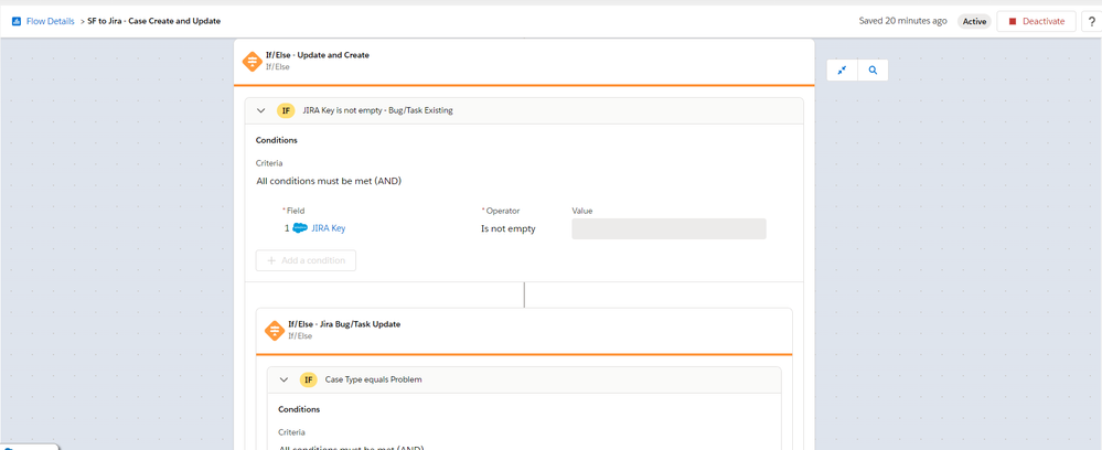

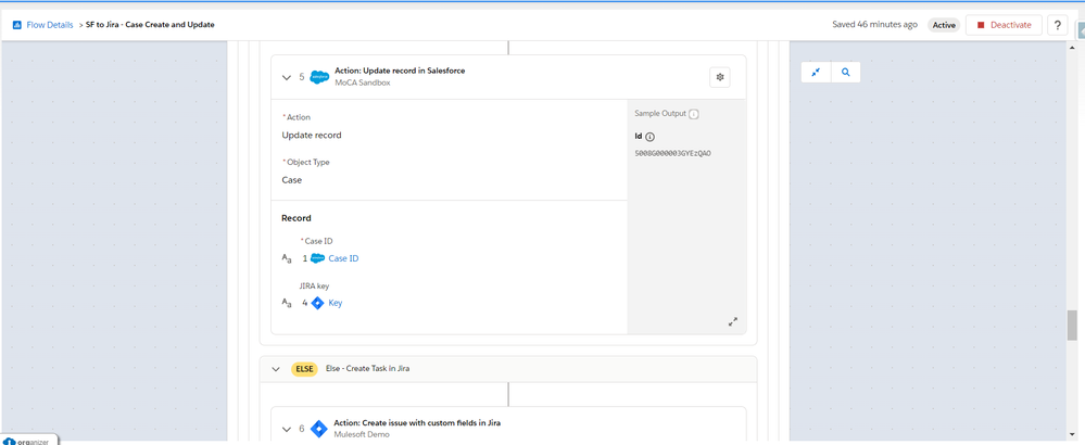

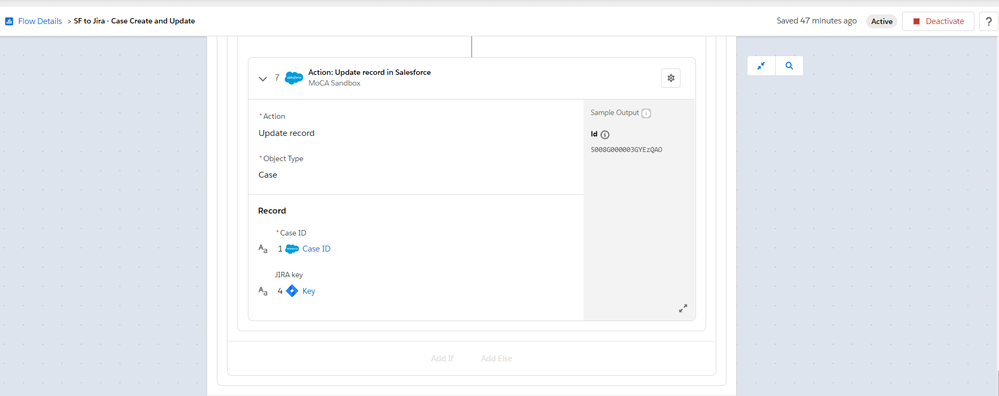

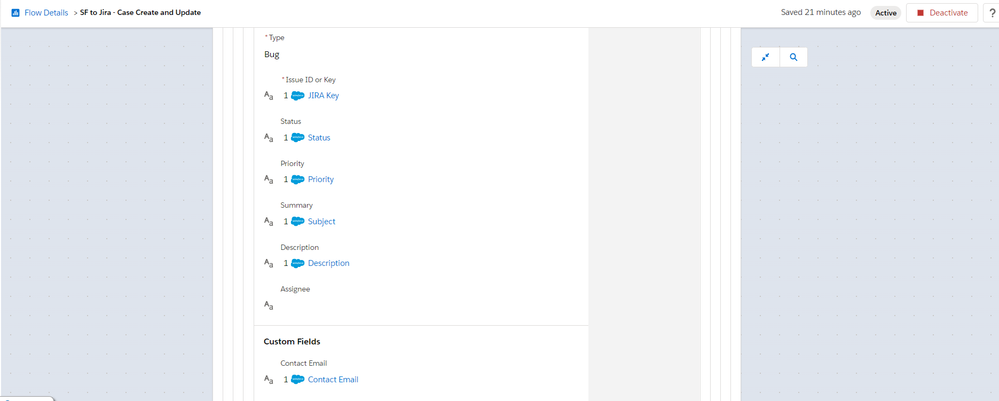

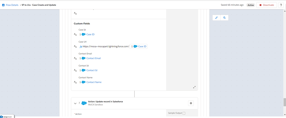

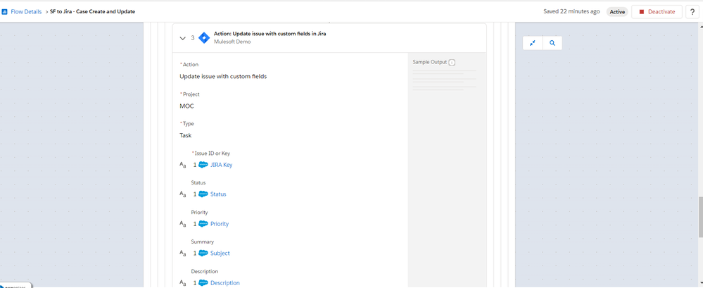

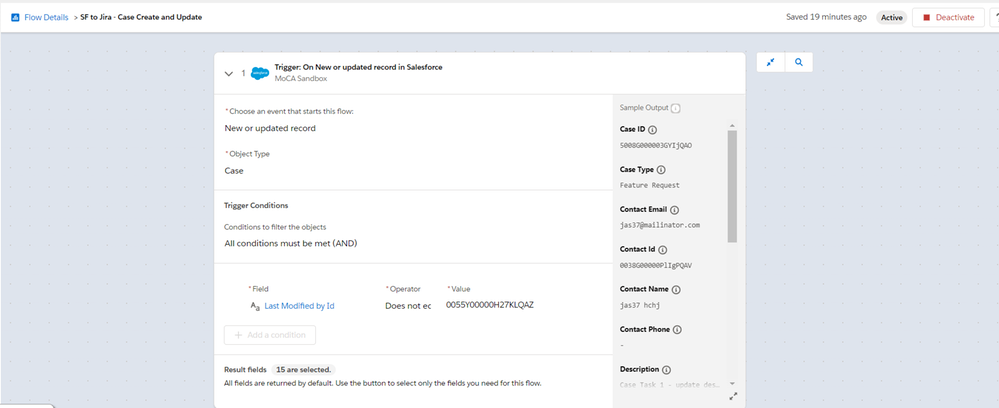

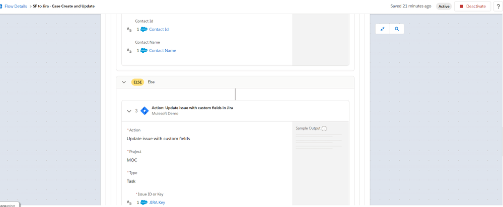

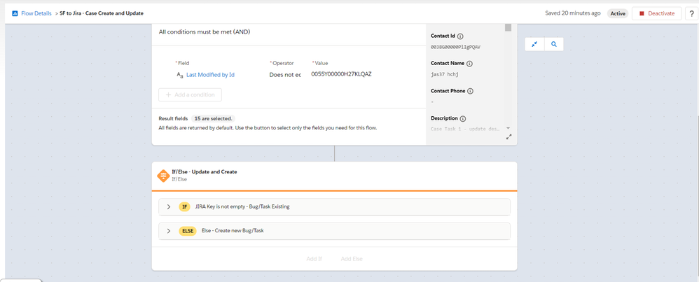

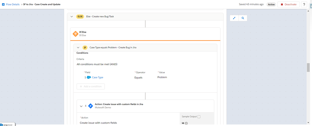

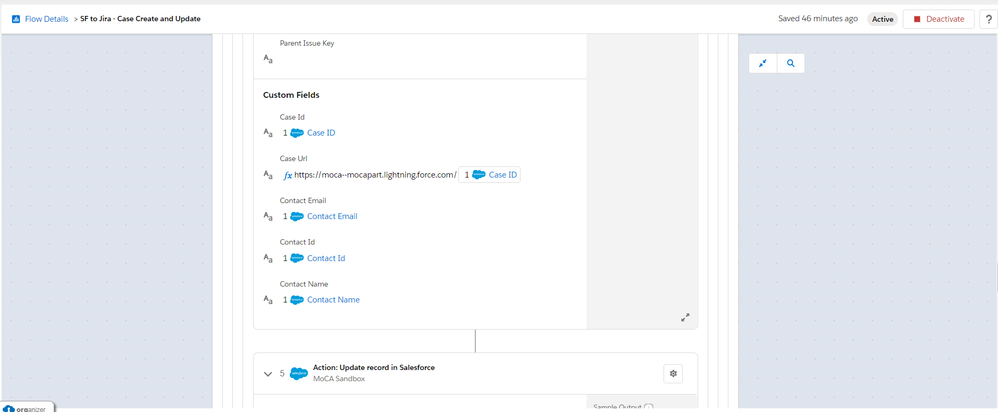

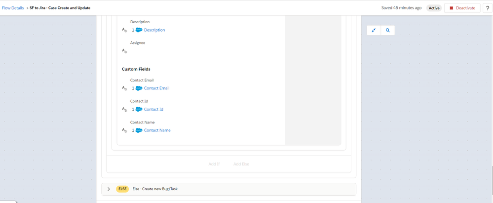

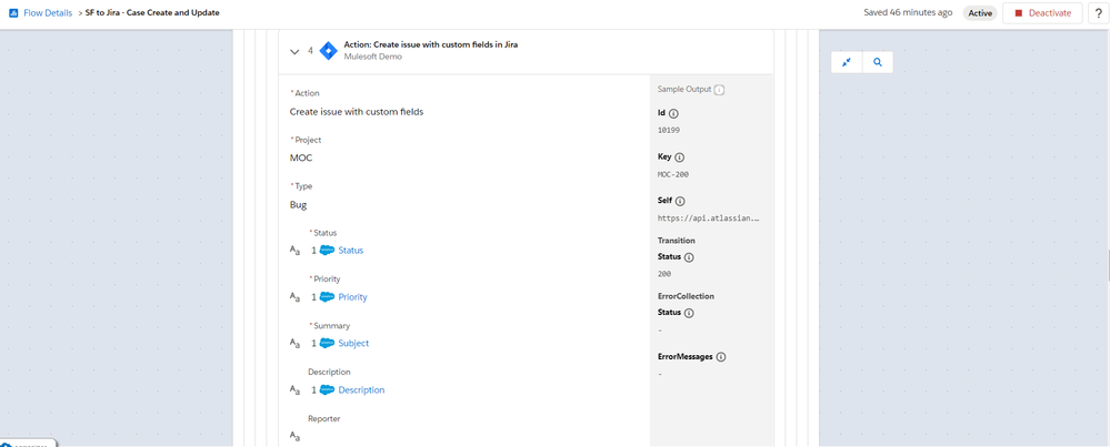

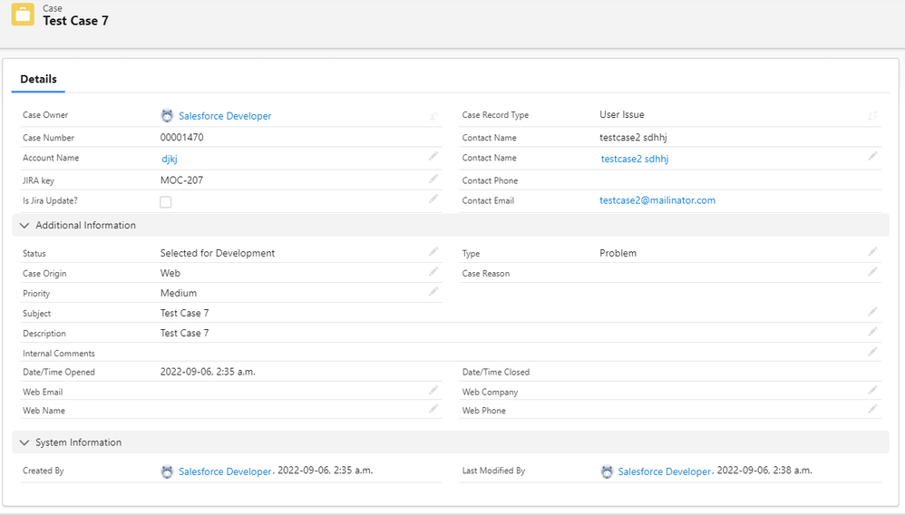

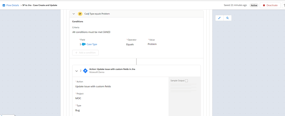

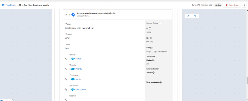

Here I attached all image that show full integration between jira to salesforce. Image for mulesoft composer flow (refer in sequential order), Jira status code, salesforce status and salesforce record image. Salesforce Case Record.png
Jira Status.pngSalesforce Case Status.png1.png2.png3.png4.png5.png6.png7.png8.png9.png10.png11.png12.png13.png14.png15.png

In Mulesoft, can you try adding 21 instead of Selected for Development in the Status field?
OK see it's mapped.

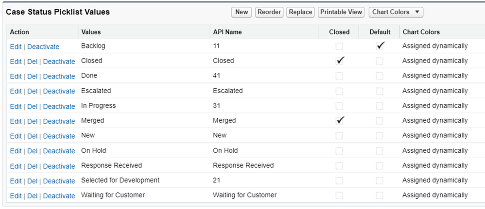

In Salesforce, I set status API name is Integer for ex. Selected for Development  status- API name is 21, In Progress - API name is 31.
Here my Scenario is, Issue create from salesforce to Jira. In Jira, I update the status from Backlog to Selected for Development. It will update in salesforce(here in salesforce, for Selected for Development - API name is 31 so it will create new inactive status Selected for Development - API name is Selected for Development in salesforce and update in record). Now I'm going to update anything like description or priority from salesforce side then it will throwing error 'Transition Id must be integer' because In Salesforce record, It stored Selected for Development - API name is Selected for Development and Jira accept Integer value.

You can set API name of status field values as integer and then when you try to map and run the composer flow it will accept integer values and the flow will not throw error.
