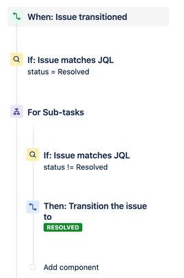

You'd rather be looking at automation to do this. You could set up a rule that:
  • is being triggered by an issue being completed;
  • for all linked issues with a specific link type
  • send a notification or add a comment
To get you started, have a look at this rule from the template library Screenshot 2021-05-21 at 00.41.29.png
The When part is what you'll need as well. If you specify your completed status(es) there, you don't need the additional if issue matches JQL.
You'll need to replace the For Sub-tasks branch with one on linked issues instead.
And to wrap up, the final action would not be a transition of your linked issues, but adding a comment or sending a notification message.
Hope this helps! I'm sure you can figure it out from here!
