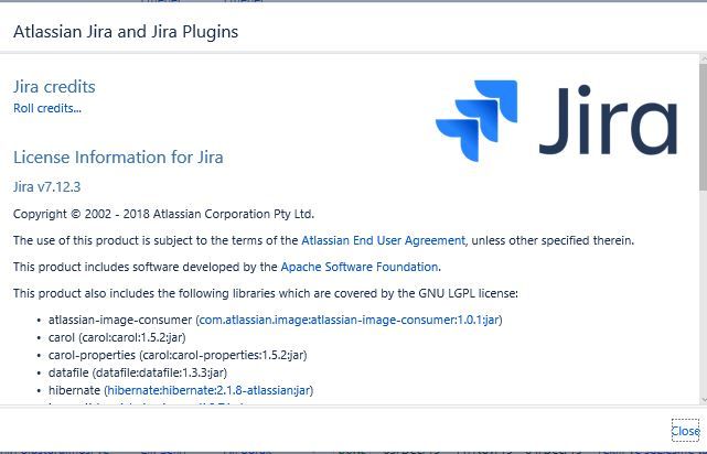

Hi, our jira version is given below.

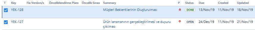

on the top, sample tasks are given. you can assume that YEK-127 is predecessor of 128. create date of both tasks are 11.11.19.  due of 128 is 13.11 and due of 127 is 24.12. task no 128 has closed at 18.11.2019, 5 days after than SLA. so we want to update the start date, SLA calculation and new due date of 127 (beacuse of the delay of 128). we need this to be done by Jira automatically rather than manuel update process.
we do not want to do it manually because we have more than 100 tasks, and dependencies are complex.
by the way, we can use sub-tasks rather than tasks if it is more convenient to solve.
