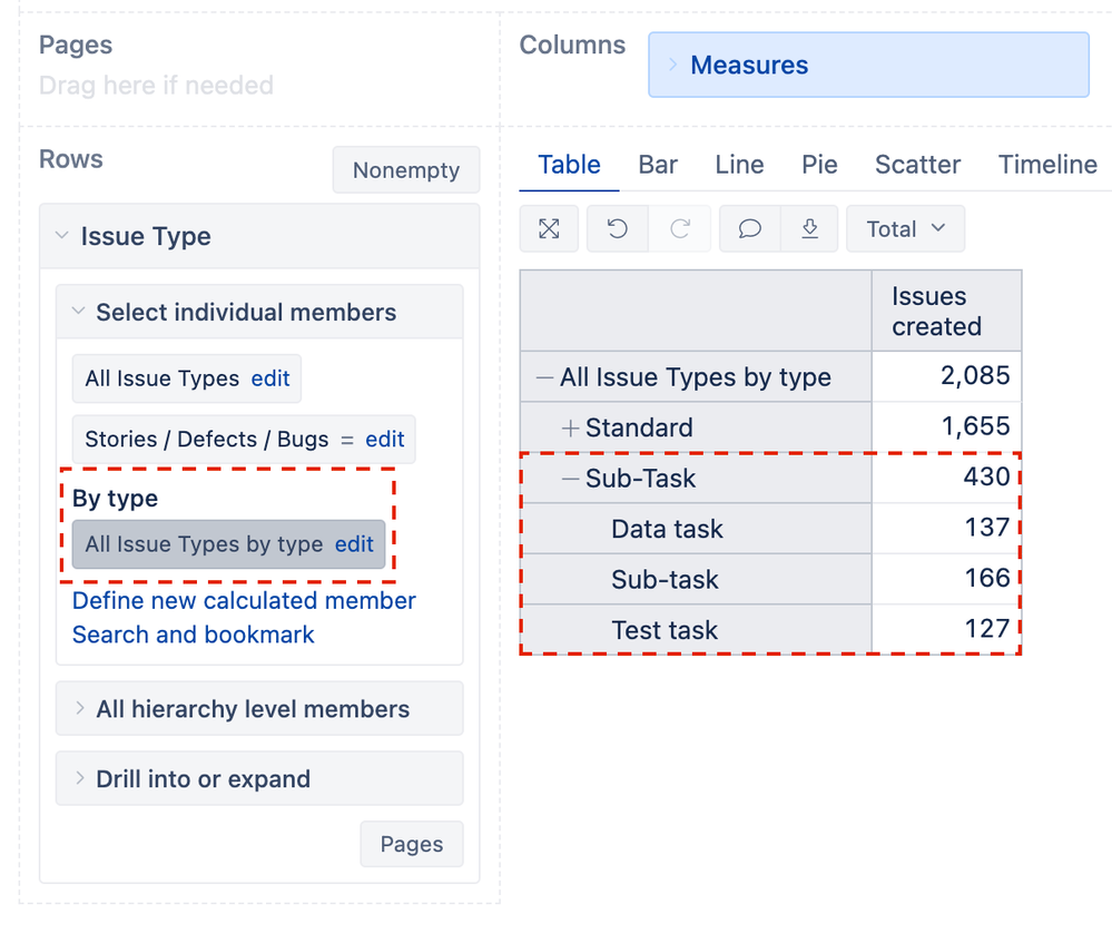

Hi is there a code that I can use to total up "Sub-tasks" on EazyBi?

You can select the Issue Type dimension in report rows and use the measure "Issues created" to view the number of issues created by type. If you have several sub-task type issues, you can switch to the "By type" hierarchy and all sub-task issue types will be grouped under "Sub-task" member. See the screenshot below:
