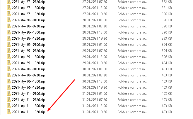

Paweł Popławski
February 14, 2021
Is it possible that I do not have newer export files, this is catalog Program Files\Atlassian\Application Data\Jira\export (newest is 2021.01.31):
Paweł Popławski
February 14, 2021
Sorry I have, just names was different.
