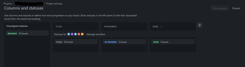

I'm having the same issue with the timeline, but I'm struggling to understand the way you managed to fix that. I can't find a setting to change the JQL for the board. I'm using a team-managed Software project, and I don't have any other projects. It's odd, but it seems like the timeline stopped working when I deleted "old project tags" (which I never used when adding issues - they've just been there since I set up the project, so I thought I would delete them).
I can see all the Epiks in the List and Issues tab (with query "project = FSS ORDER BY created DESC", but not in Board or Backlog. Creating a new Epik just causes it to disappear from the two latter. When I create a new project, the timeline shows fine.

Wojciech Cranfield
October 3, 2024
@Jussi SoroI don't see anything like this there. I can only change the columns and statuses from this page.
Jussi Soro
October 3, 2024
Oh, that's different in Team Managed projects. You can't edit the board filters on team managed projects, as they always only bring the issues in that project. So your problem might be somewhere else than filter. I don't have an answer for that though, why that is happening.
