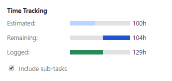

I have a story with sub-tasks. On story level I have the original time estimate of 100 hours.
In the sub-tasks I have logged time that exceeds the 100 hours by 29 hours.
Logged time says: 129 hours
But remaining time says: 104 hours (see screenshot added)
There are no estimates added to the sub-tasks - there is only the one estimate for the user story.
Is there something wrong with the cloud version? Or am I doing something wrong? Why does it say that the time remaining is 104h?
The percentage of the graphs appear correct but the numbers are wrong.
Is anyone else experiencing this?

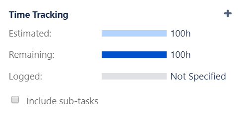

Hi
It would be useful for you to untick Include sub-tasks and give us another screenshot. I have an idea, but would rather wait until I see the results of the next screenshot
lisa.skantze June 12, 2018
Hi Warren,
Here you go!

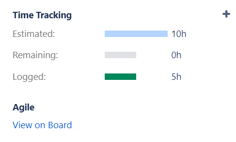

test3 is showing 100%. Can you give a screenshot of the time tracking within test3?
lisa.skantze June 13, 2018
Warren
June 13, 2018

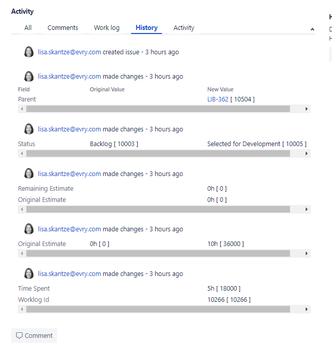

So the remaining is 0, which implies everything is correct. But ... how did remaining get to 0? You may need to check the History tab of test3 to see what's happened. I can't know unless you show me the History but I suspect that possibly you've set the remaining time to 0, without meaning to
Hi Warren,
Ok, attaching history screenshot.
The only thing I did was add 5 hours to the work log. I would expect 5 hours to remain.
//Lisa
Warren
June 13, 2018
Okay, so I can see where you've gone wrong. If you set the Original Estimate, but leave the Remaining Estimate blank, it populates the Remaining with the Original value.
What you had done was to set both estimates to 0 (3rd row), then you changed the Original to 10h (the second last row). At that point, your Remaining would still have been 0. Then you logged 5h, and Remaining is still 0.
So, when you create a sub-task, add a value to Original Estimate (say 10h), but leave Remaining blank; once created, you'll see that Remaining is now also 10h. As you log time, the Remaining will reduce until 0, which is what you are expecting.
I hope that this is clear

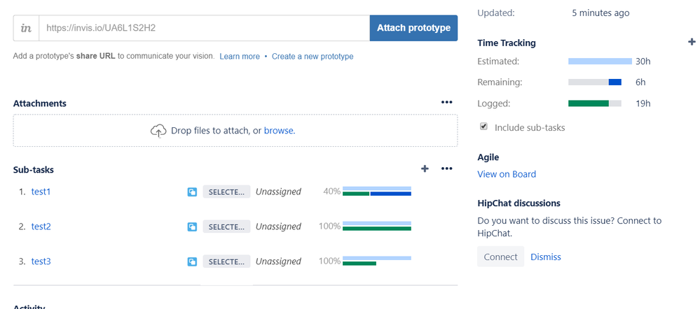

Hi Tyler,
I just tried to add one story without any time estimate.
I added three subtasks with estimate of 10 hours each.
I logged:
Sub-task 1 - 4h
Sub-task2 - 10h
Sub-task3 - 5h
19 hours logged. Still remaining time says 6 hours? This should be 11 hours.
Thankful for any input on this. :)
