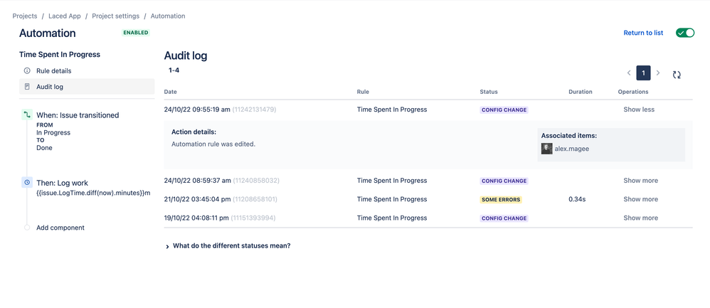

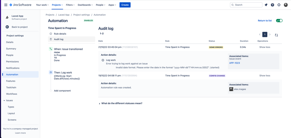

Hi Team!

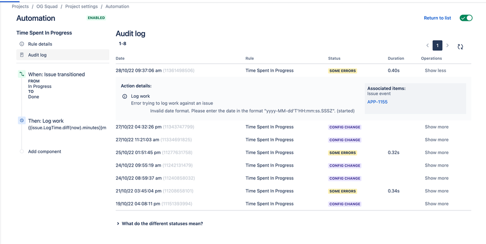

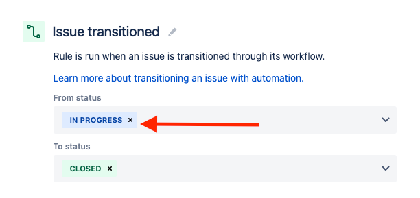

So I want to log time spent on tasks automatically.
I have a custom field "Worklog", which records the date when the task accepted the "In Progress" status. When the status changes, the worklog should record the difference between the "worklog" field and the current date in minutes.

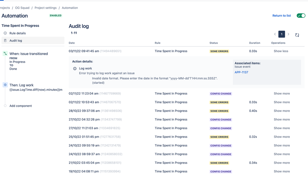

The problem is that every time the automation is triggered, in the audit log I see the error:
"Error trying to log work against an issue. Invalid date format. Please enter the date in the format "yyyy-MM-dd'T'HH:mm:ss.SSSZ". (started)."

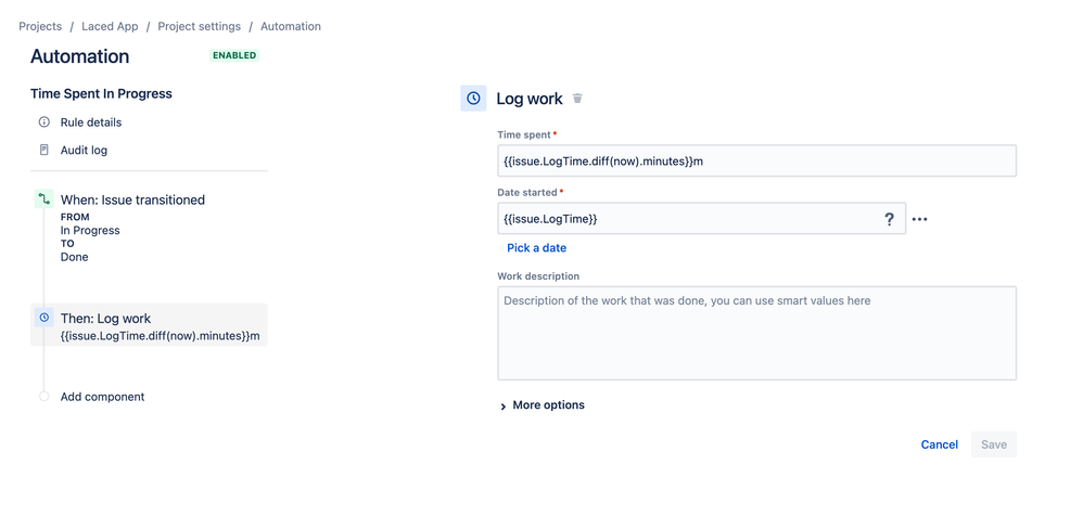

Hi @Bill Sheboy ,
So I decided to change the custom field to 'LogTime' and used your smart values above but still, nothing is being tracked or automated?
RE full date/time difference. I mean I do want it on a granular level so the this would be a requirement.
Screenshot 2022-10-25 at 09.37.26.pngScreenshot 2022-10-25 at 09.37.10.pngScreenshot 2022-10-25 at 09.36.56.png
Bill Sheboy
October 25, 2022
In your screen images, the LogTime field is empty, and so I would not expect a value to be created for the diff().  Did you post the correct images?
What is the type of your LogTime field: text, date/time, something else?
Next, have you confirmed that "LogTime" is the correct smart value for that field name?  To check on that, please use this how-to article: https://support.atlassian.com/cloud-automation/docs/find-the-smart-value-for-a-field/

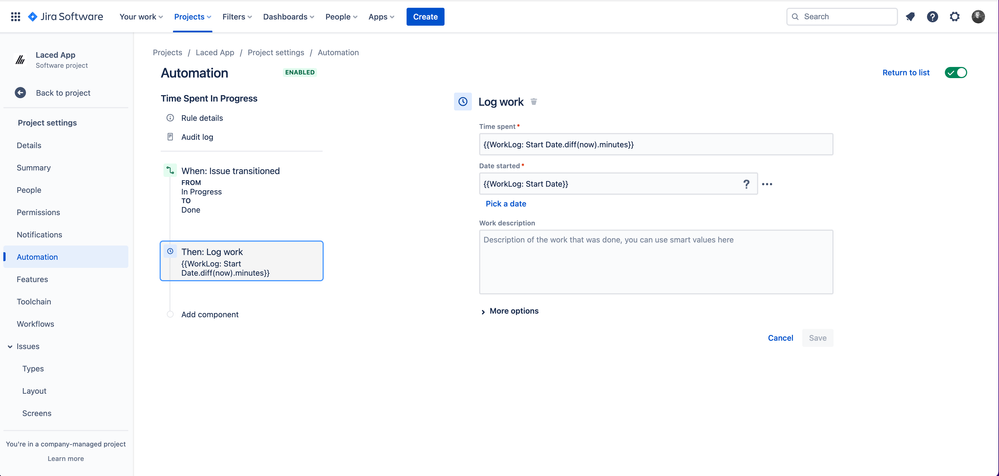

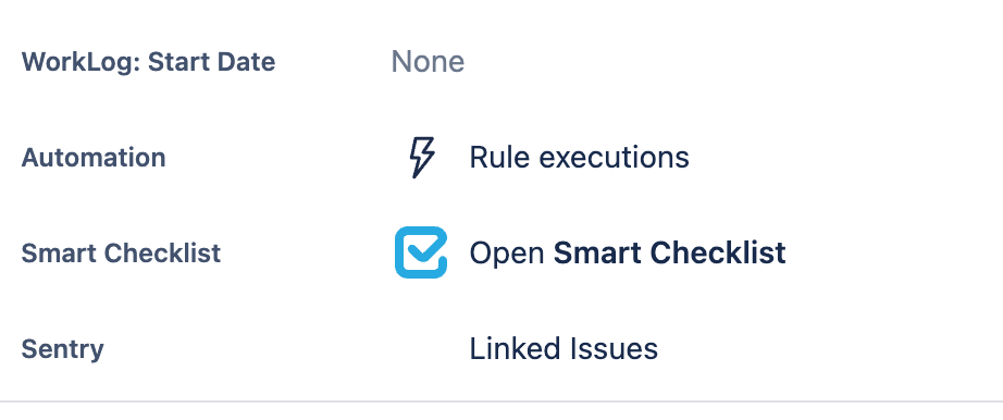

When I get errors like that I like to add Log Action actions to my rule to print out to the rule Audit Log the values that the rule is trying to use. This can help you figure out if the value you are trying to use matches the field type where you are trying to use it. You may need to do some conversion or formatting. The error message suggests you need to format the data, but you may find that the value referenced isn't even valid.
Looking at the last image you posted it appears that the "Worklog: Start Date" field has no value. What type of field is that? I think you need to go back to the rule (or workflow transition) that sets that field and find out first why that field is blank. Given that it is blank, then your rule actions to try to set another Date/Time field to that value understandably won't work.

It's a very good point. So I thought the value would be populated when you move it across statuses? Is this not correct? If not, how do you set the transition to populate it first?
I've now changed the field names to make it easier.

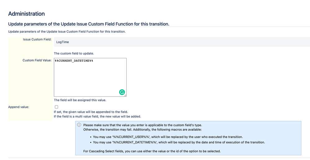

You would need to add a Post Function to the workflow transition to set the field value.
https://support.atlassian.com/jira-cloud-administration/docs/edit-an-issue-workflow/#Configure-post-functions
Alex Magee
October 26, 2022
Perfect thank you @Trudy P Claspill
So I've added the following post function logic to the transition from Backlog to In progress  - would this work?

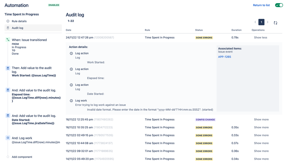

Alex Magee
October 31, 2022
So I still seem to get the wrong error @Trudy P Claspill ?
Screenshot 2022-10-31 at 08.47.43.pngScreenshot 2022-10-31 at 08.49.08.pngScreenshot 2022-10-31 at 08.49.57.png
Trudy P Claspill
October 31, 2022
Hello @Alex Magee
The clue is in the error message. You need to properly format the value you are submitting to the Date Started field in the Log Work action.
If you look here: https://support.atlassian.com/cloud-automation/docs/jira-smart-values-date-and-time/#--
Under the heading {{[date].[dateformat]}} you will find the functions for formatting date/time values. Find the function that matches the format you need and add that to the smart value you are using in the Date Started field in the Log Work action.

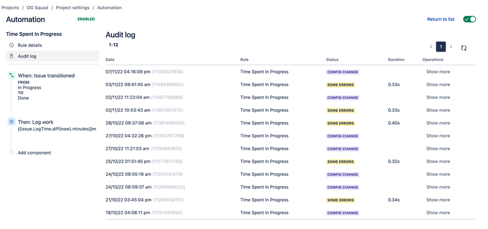

Alex Magee
November 6, 2022

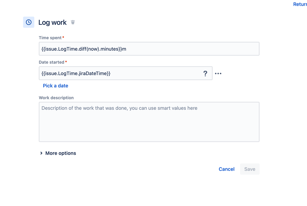

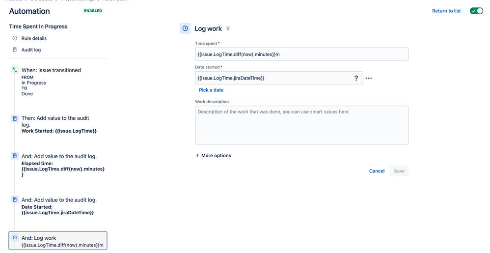

Hey @Trudy P Claspill ,
So I've now formatted the 'Date Started' field according to the article you posted under {{[date].[dateformat]}}
It logs the date and time when it transitions over from 'refined' to 'in progress' status with the workflow also listed below.
But it doesn't seem to process the log time across 'in progress status' to 'done' status with the same error message.
Really not sure where I'm going wrong - please help aha :)
Cheers,
Alex
Trudy P Claspill
November 6, 2022
Hello Alex,
The format you selected is not correct.
The error message tells you the format you need:
You need to use the formatting option that matches that.

Hey @Trudy P Claspill but where do you input this format and what does this look like? And then do you just input this into the log work component or where do this go? Does this need to be edited at all like below?
Time spent:
{{issue.WorkLog.diff(now).minutes}}m
Date started:
{{issue.LogTime.mediumDateTime}}
Trudy P Claspill
November 7, 2022
Hello Alex,
You are part way there.
The error message has "(started)" at the end. That indicates that the data you are trying to assign to the "started" field (Date Started) is in the wrong format.
You got part way there by changing the smart value you have in the Date Started field. Adding the ".mediumDateTime" function to that does format the data "issue.LogTime", but it is not the correct format. You need one of the other format functions from the reference page.

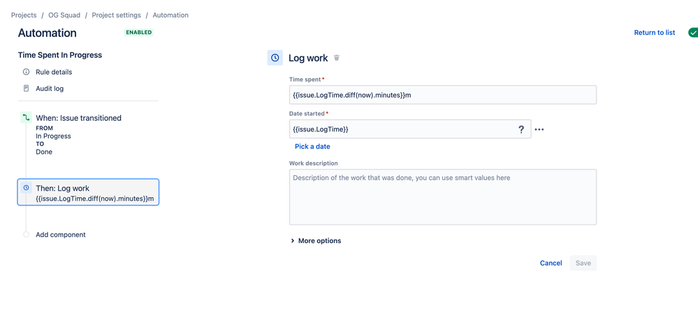

Alex Magee
November 10, 2022
So I've now added the format based on the error message but nothing seems to be pulling through now?
Trudy P Claspill
November 10, 2022
The Audit Log shows that you made your configuration change, on Nov 7 and the rule has not been triggered since then. The rule Trigger says it will run when an issue is transitioned from In Progress to Done in the project specified in the Rule Details Scope. Has such an issue transition occurred?
Alex Magee
November 14, 2022

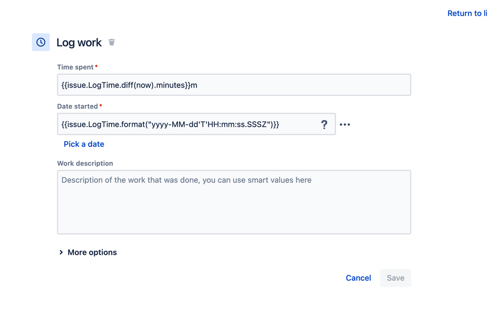

So its now started to track the transitions again but gives the same error :(
I've now added a custom format which exactly matches the one provided in the error documentation (seen below)
But the same error occurs (seen below)

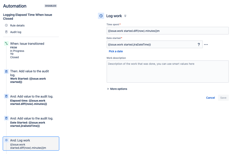

Trudy P Claspill
November 15, 2022

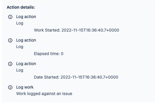

In your rule add a Log action to print the value of the LogTime field.
Add another rule to print the value you are trying to assign to the Date Started field.
Add those before the Log Work Action.
Show us the Audit Log for an execution of the rule after those changes.
The same rule seems to be working fine for me.

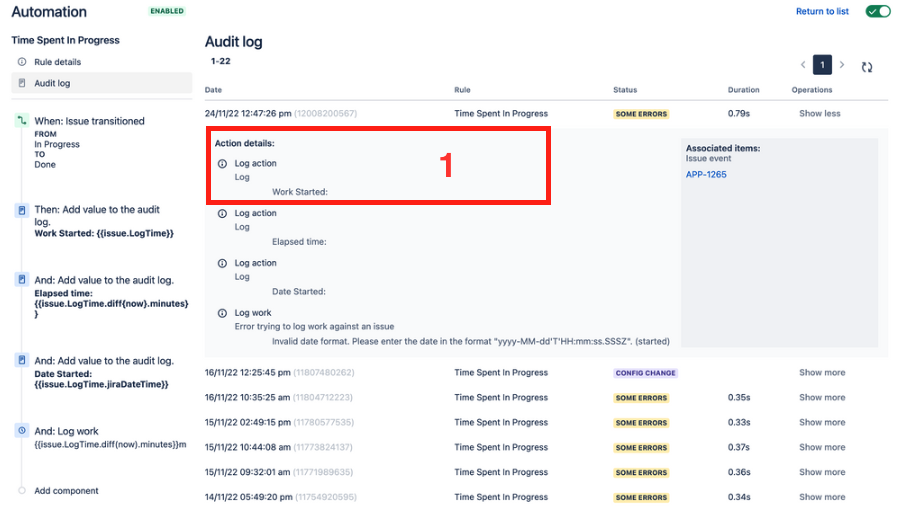

Alex Magee
November 28, 2022
So I've mimicked your exact set-up but again receiving errors again :(
It still seems to be formatting issues on the date and then the log actions have not been logged ?
Trudy P Claspill
November 28, 2022

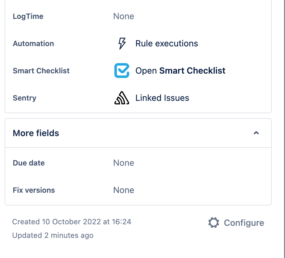

(1) indicates that the when this particular rule execution occurred there was no value in the LogTime field for the issues that triggered the issue.
When there is no value in that field in the triggering issue, nothing else will work since everything else is based on that field having a valid value.
Confirm that the issue denoted on the right in the gray box actually has a Log Time value.

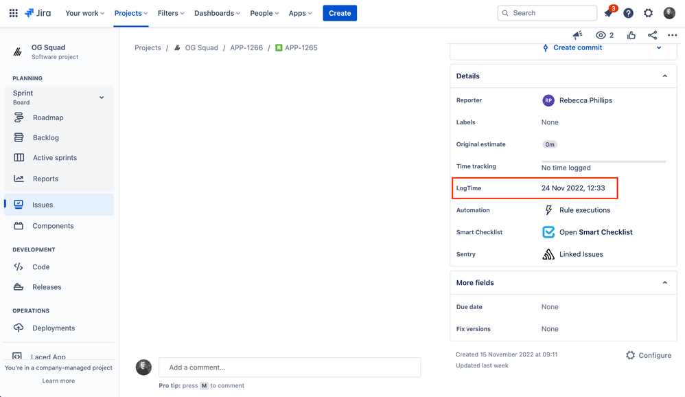

Alex Magee
November 29, 2022

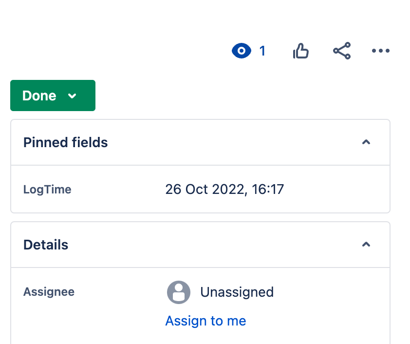

So it does look like there was a value in the LogTime field but it didn't log it?

Trudy P Claspill
November 29, 2022
The other possibility is that you are not referencing the field correctly within the automation.
Have you confirmed that "LogTime" is the correct smart value for that field name?  To check on that, please use this how-to article: https://support.atlassian.com/cloud-automation/docs/find-the-smart-value-for-a-field/
