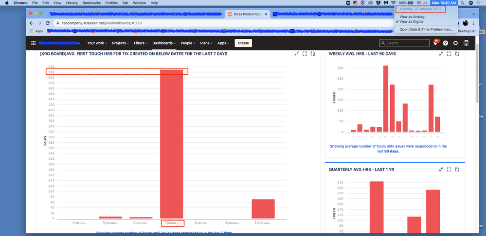

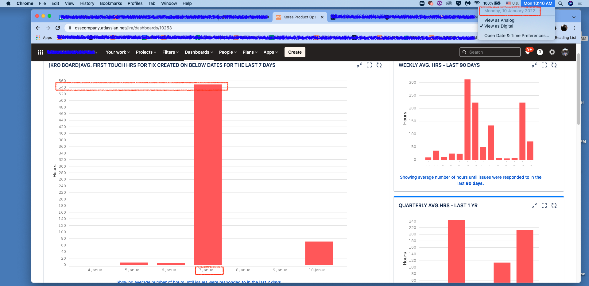

Screenshot attached below.
As you can see from the screenshot, today is Jan 10th 2022, but on the Time to First Response Time chart, it says tickets created on Jan 7th 2022 took approximate 22.5 days(540/24=22.5) to respond. It doesn't make sense as today is Jan 10th, the max hours can be only 24*3=72hrs.
We are trying use this Time to First Reponse gadget to set out SLA and according KPI.
But if it occasionnly shows this kind of bugs, it severely damages the credibility of it.
Does anybody know what might have caused this malfunctioning?

Hi Ted. I find these charts confusing too and TBH rarely use so my understanding may be rusty. I believe the flaw in your thinking is grounded in your comment "...tickets created on Jan 7th...". I believe if you look at the issue defining the bar on the 7th you will find some will have been created prior to the 7th. The TTFR report triggers on an issue being responded independent of creation. Basically, it presents all issues that achieved the "first response" criteria in a given day. For example ...
day 1: 5 issues created, First response = 1 (leaving 4 still pending)
day 2: 7 issues created, First response = 6 (3 from day 1, 3 from day 2; pending: 2 from day1, 4 from day 2)
etc...
I would recommend that you dive into a snapshot of that report and really understand how it is working to determine if indeed there truly is a bug. I know this chart is similar to time to close and you're a software and I believe there's a good article out there that describes how to consume it. If I can find it I will drop it in here because I think it is applicable.

Thanks a ton Jack! you were right on "it presents all issues that achieved the "first response" criteria in a given day."
