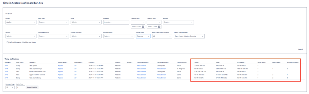

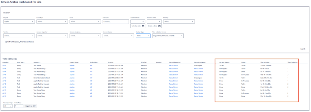

If you're looking to avoid manual calculations for multiple issues, consider using Time in Status Dashboard for Jira , an app developed by our company. This app accurately calculates time spent in status, including repeated entries and exits, allowing you to compare its results with your current app.
You can chose between a perspective where each time in status is present in a separate column or
each status change is represented in a separate row
Not sure how you are extracting the data but this app allows you to export both perspectives in csv format.

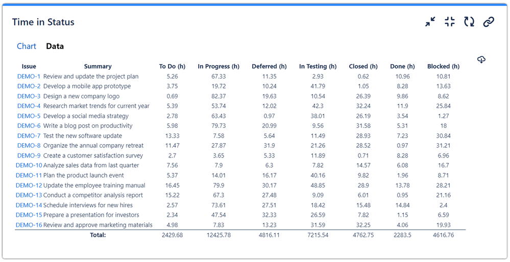

If you want to try another add-on, our Great Gadgets app offers a Time in Status gadget that can display various charts based in total and average time in status. In addition, it can display a Data tab with the time-in-status for individual issues, which can be easily exported in CSV format for further processing.
