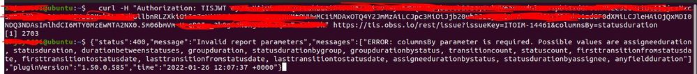

curl -H "Authorization: TISJWT <token>" https://tis.obss.io/rest/issue?issueKey=<issue_key>&columnsBy=statusDuration
I have tried this but I got this error.
{"status":400,"message":"Invalid report parameters","messages":["ERROR: columnsBy parameter is required. Possible values are assigneeduration, statusduration, durationbetweenstatuses, groupduration, statusdurationbygroup, groupdurationbystatus, transitioncount, statuscount, firsttransitionfromstatusdate, firsttransitiontostatusdate, lasttransitionfromstatusdate, lasttransitiontostatusdate, assigneedurationbystatus, statusdurationbyassignee, anyfieldduration"],"pluginVersion":"1.50.0.585","time":"2022-01-25 12:30:45 +0000"}

So, error 400 means, that authorization is ok, but you are sending invalid parameters for the report. But it is weird, because according to the error message - columnsBy parameter is missing, but you are sending it.
Have you tried to use "statusduration" value instead of "statusDuration"?
Arjay Villavicencio
January 26, 2022
I have tried both but no luck. Kindly check the below image.

I've tested it today and it worked for me. I had to add parameter calendar.
https://tis.obss.io/rest/issue?issueKey=<issue_key>&columnsBy=statusDuration&calendar=normalHours
Your error message is really strange (like the parameter statusDuration is not recognized). Maybe you can try to ask the vendor, what could this be, I'm sorry I really don't know what's wrong. It looks right.
