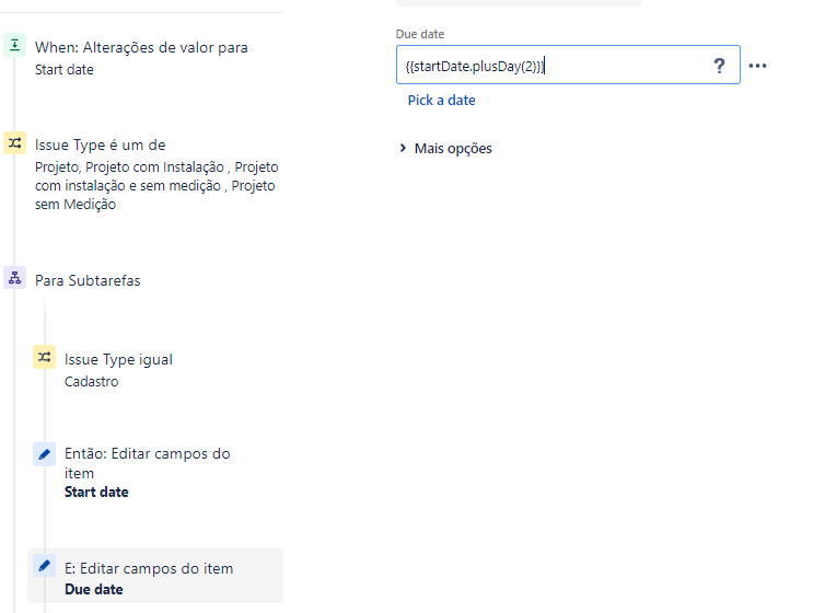

how do I always leave the deadline at a certain number of days from the start date?
I'm using {{startDate.plusDay(2)}} but it's not working.

hi @Trudy P Claspill is the rule wich i used
Trudy P Claspill
September 2, 2021
It appears that your rule is intended to modify the Start Date and Due Date on sub-tasks when the Start Date on a parent task is changed. Is that correct?
How is your rule not working? Is Due Date not getting changed at all, or is it getting changed to an unexpected value?
The Due Date field is being set based on the value of the Start Date field in the subtask. What code are you using to se the subtask Start Date field? Is that working?

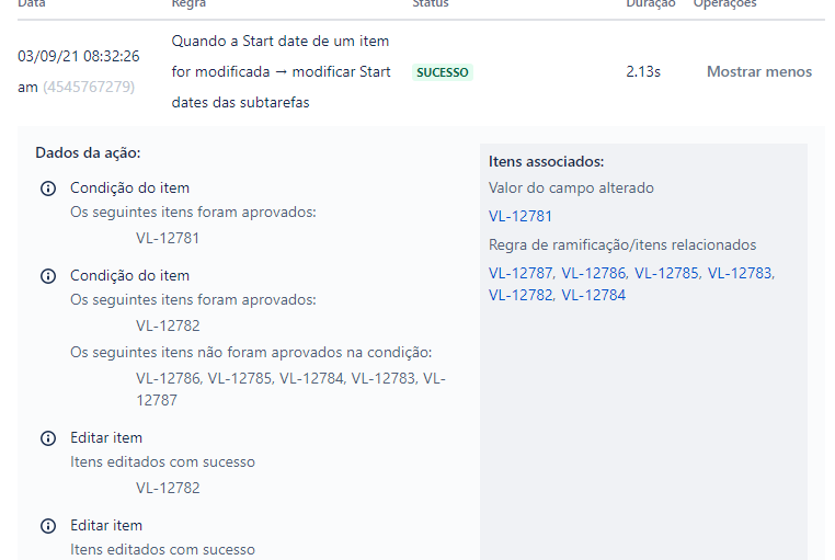

What does the Audit Log for this rule say when the rule is executed?
- The audit log presents "sucess", don't detect bugs.

Please consider using the Log action to write values into the audit log for
1. The subtask Start Date, immediately after the action where you change that value
2. The value result of the calculation you are using to set the Due Date field, before the action where you set that field.
3. The value of the Due Date field after the action where you try to set it.
https://support.atlassian.com/jira-software-cloud/docs/debug-a-rule/
And post the results of those Log actions. That will help with debugging the rule.

I note in your screen image you have {{startDate.plusDay(2)}}
However the function name is actually plusDays()
Please update that to learn if it helps.  Thanks!

The log audit...
