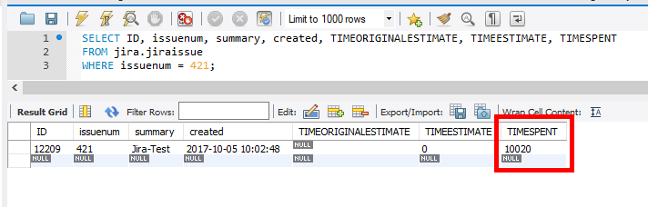

Obviously the time displayed in time tracking is wrong. To confirm this I selected the data directly from the MySQL database:
2017-10-05 10_25_13-MySQL Workbench.png2017-10-05 10_26_47-MySQL Workbench.png
