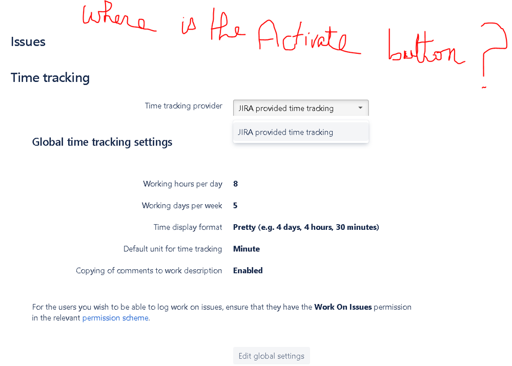

Our time tracking setting page does not the "Activate" or "Deactivate" button.
Where to find it?
See attached screenshot below :
Thank you.
Nic Brough -Adaptavist-
January 4, 2023
Why are you looking for an activate button?  Just set the time-tracking to what you need.

I am looking for this button because the LOG WORK does show as an option in the ISSUES 3-dot top right drop down menu.
I thought that it doe snot show because the Time-Tracking is not activated and ALL documentation that I found on the Internet is saying that in order to activate the time tracking you have to click on THAT button that I do not see on my page.
For example:
https://confluence.atlassian.com/adminjiraserver/configuring-time-tracking-938847808.html

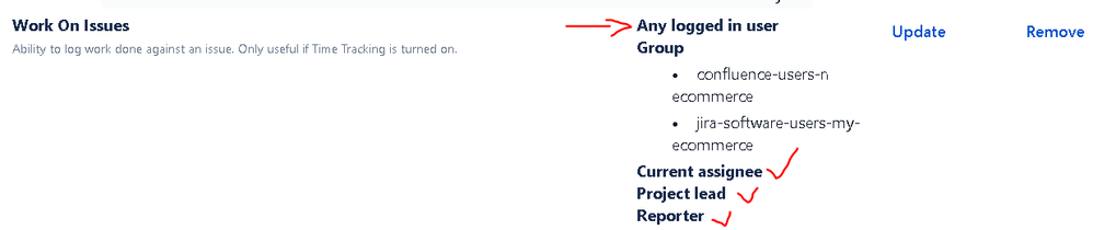

michellevy
January 4, 2023
Thank you for your feedback.
That work on issues settings is the very first thing I did, see screenshot below and that DIDI NOT fix the issue so I spent another almost 3 hours to find find all sort of feedback and the only 1 left that made sense is the time-tracking activation, which you now say does make sense??

michellevy
January 4, 2023
The assignee or reported cannot see the log-work option, but if you look at the  last screenshot you will see that I already gave both the access for this.

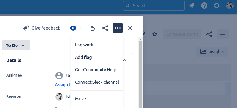

January 4, 2023
I am sorry, I was very unclear in my request for more information.
I would like to see the profile of a user that places them in one of the groups in your screenshot, and to see the options on an issue on which they cannot log work, where the issue has them as assignee or reporter.
This can be done in one go if you open up an issue where they're reporter or assignee, and hit the options menu (this will partially obscure some fields we want to see, but you can see in my screenshot that I can match the reporter to my login by the icons for them)

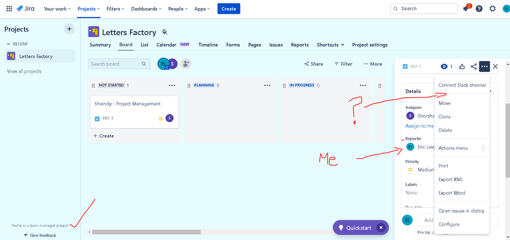

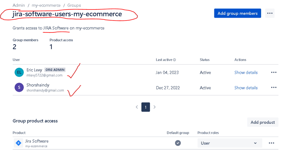

michellevy
January 4, 2023
Thank you for continuous help.
See attached below, 2 screenshots, one showing the issue with options-drop-down showing the absence  of the "log-work" option.
and 2nd screenshot shows the gr oups where both users are locate din : Shaindy and Eric , I am the reporter and she is the assignee.
We are both in that JIRA group that was added on then work-on-issue permission list and yet we do not have the "log work" option.
In that issue screenshot, I am logged as "Eric Levy" (that is me : michel eric levy)
Thank you.

January 7, 2023
Um, your screenshot shows that you are in a team-managed project.
That means the permissions you showed us are irrelevant - they don't apply to team-managed projects.
In a team-managed project, the permission is done with the roles.  Go to project settings -> access and amend the user's role(s), enabling them to log work.

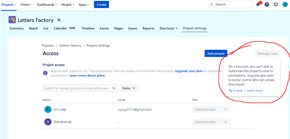

michellevy
January 8, 2023
Thank you for the reply.
It does not look like you can change the role on a free account See attached screenshot)
Conclusion (after almost 9 hours of my time): You cannot get users to log work on a free account.
