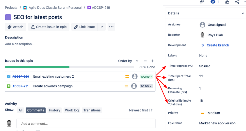

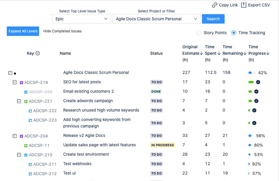

Hi @atarab
So the issue is you want to log time against sub-tasks and roll up those estimates to parent Stories, then to Epics and report progress in terms of time spent / remaining estimate?
We put together a plugin called Agile Docs which does exactly this.
It rolls up time estimates from Sub-tasks all the way up to User Stories, Epics and even entire projects or filters.
The progress bar for "Time Progress" is based on Time Spent / Time Remaining.
In addition it makes these rolled up estimate fields available for use inside issues, so you don't need to set up any automations.
Let me know if this is what you're looking for.

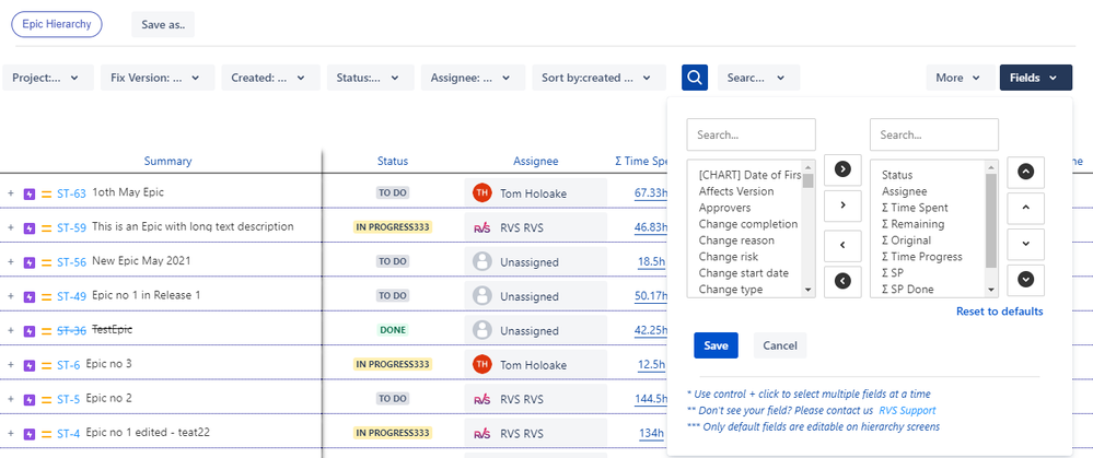

Hi @atarab
As an alternative, you can also try out our plugin, The app provides 5 important features, for roll ups of time estimates and stpry points, along with time tracking of issues and users.
Agile Tools : Epic Tree & Time in Status
1) Worklogs & Time tracking Report :- Track time spent by resources with multiple filters / category / grouping features
2) Timesheet :- View/Enter your time spent for multiple days
3) Links Hierarchy :- View/Manage roll up for hierarchy (up to 10 levels), based on your Issue Links parent child relationship.
4) Epic Hierarchy :- View/Manage roll up for standard Jira hierarchy. Epic -> User Story -> Subtask
5) Time in Status :- More than 7 types of Time in Status reports to track your issues.

@Rahul_RVS
Thanks for sharing. Does this tool allow you create custom columns?
Rahul_RVS
Atlassian Partner
August 6, 2021
Hi @Fabian Lim
Thanks for your response. If I understand your query correctly, the tool does allows to view/add custom columns on the hierarchy report. The column ordering can be changed as per the need. Epic Hierarchy - Custom Columns.PNG
Also it shows roll up of custom number fields as well.
Please do let me know if that is what you were looking for.
