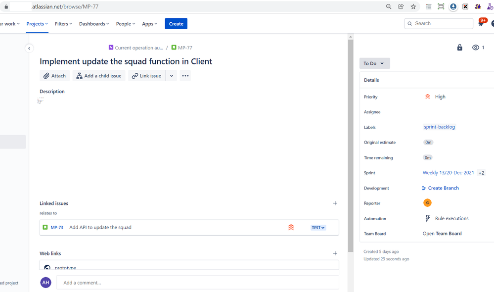

hey @Trudy Claspill to answer to your question let me share some screenshot.
You can see my board filter
You can see the issue type in NextGen which does not appear in my classic board.
Trudy Claspill
December 14, 2021
@Arthur Harutyunyan
I see that you marked this post as Answer Accepted. Is your issue resolved? If so, what was the issue? Was it what @Gaurav suggested and not all statuses were mapped to columns?

hey @Trudy Claspill seems like yes,
Actually I totaly forgot about the statuses, as I have different workflows and statuses in my classic projects vs new nextGen project, agree, its funny )))
anyway, I didnt managed to fix that yet, but Im pretty sure, this issue is because of the different workflows.
