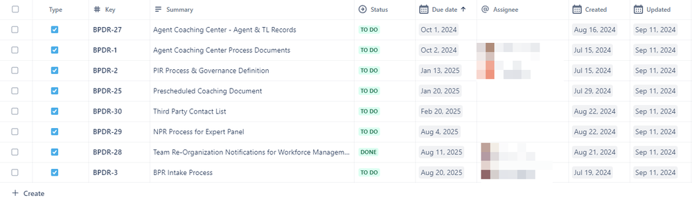

2. List view shows 8 issues in total all in To Do Status except 1 in Done

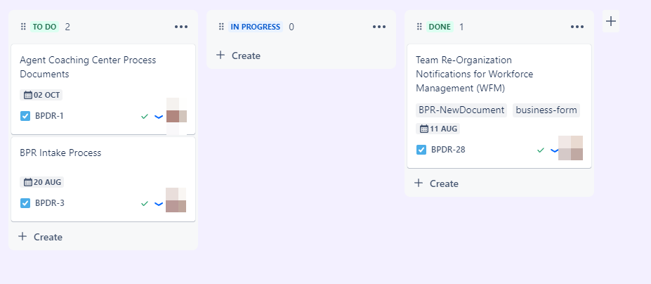

3. Board view shows 2 issues in To Do status and 1 in Done

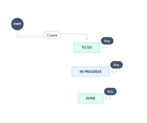

4. Workflow is very basic with all statuses being able to turn into all other statuses.

7. Other observations: Our first tickets we created, also manually All consistently stay on the board and do not vanish. BPDR-1 and BPDR-3 (Both assigned to me).  However, BPDR-2 does not show on the board, created the same day as 1 and 3 but assigned to a co-worker. All 3 that show on the board consistently were assigned to me.

Your Status named "To Do" has gotten assigned to the "Done" Status Category. This is indicated by the fact that the "To Do" status is shown as a green lozenge.
The hiding of "Done" issues applies to all Status values that are in the "Done" Status Category . In your current configuration both your To Do and Done Statuses are assigned to the Done Status Category, therefore issues in both of those Statuses will be hidden automatically when they have been in those Statuses for 2 weeks or longer and have not otherwise been updated.

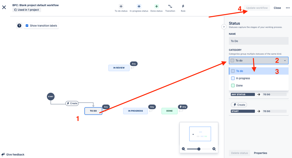

However, it is a fixable problem that the To Do Status issues are getting hidden. You simply need to change the Status Category for that Status to the "To Do" Status Category instead.

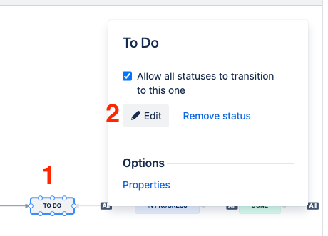

In the New Workflow Editor you would follow the numbered steps shown in this image.

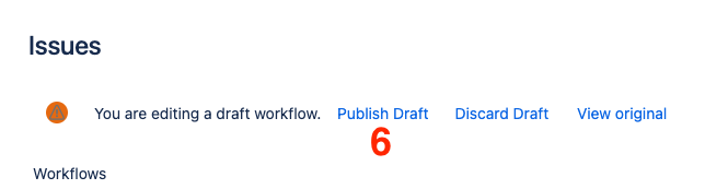

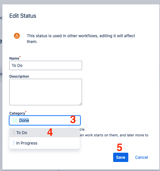

In the original Workflow Editor you would follow the numbered steps shown in the images below.
Screenshot 2024-09-11 at 3.39.39 PM.pngScreenshot 2024-09-11 at 3.40.31 PM.png
When you have the To Do Status properly assigned to the To Do Status Category, those issues will no longer be automatically hidden.

100% this was the issue! Not sure how that got set as a Done Status but it absolutely was and these instructions were easy to follow to fix it :) Thank you Thank you!
