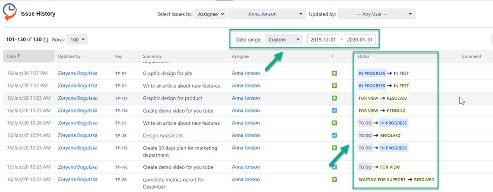

For this case, you can try Issue History app. It lets you get the history of any changes, including statuses. But it hasn't a gadget for Dashboard.
If this solution is interesting for you, let me know, and I can help you get the data you need.

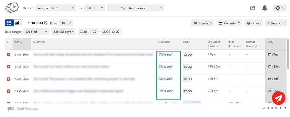

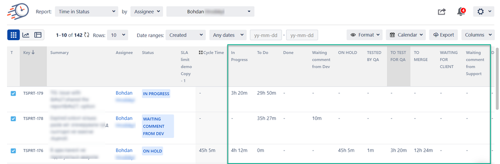

You can try a third-party add-on - Time in Status for Jira Cloud. It generates both Time in Status and Assignee time reports.
Time in Status report shows how long an issue has been staying in each status. So you can monitor at which stage some problems or delays occur.
Assignee time report shows how long each Assignee has been assigned to each issue. It helps to get info on how long it takes to solve each of them.
Is that what you need?
