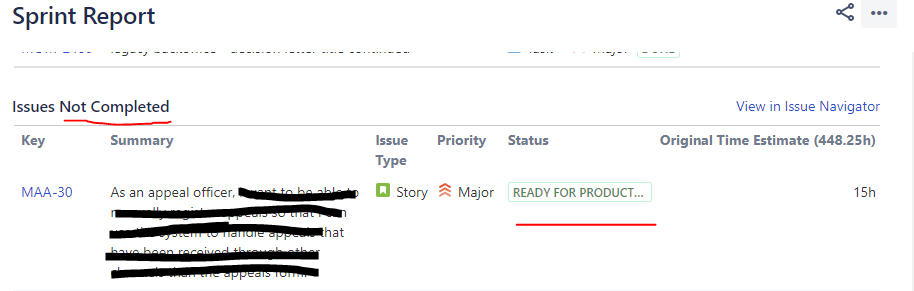

In our board we have 8 columns to manage progress. We move tickets to next column as we go. The columns at the end are considered Done from developers perspective and we want the Sprint report to reflect this.

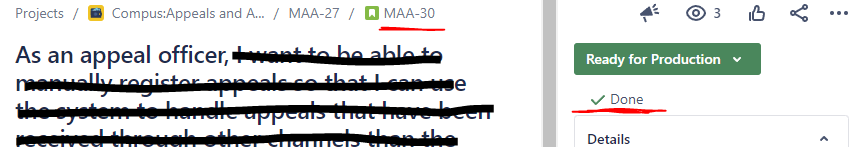

In this example we have a ticket ready for production . This state is in category Done. But the ticket is listed under Not Completed and our Burn Down is not telling the truth
What can we do to tell Jira Sprint Report that a certain status is considered Done?

An issue is only done when it is in the last column of the board.  You need to put all the status you consider to be done in the last column.

But we have managed to set the resolution to Done when moving the tickets to the columns considered done. I find this behaviour not logic.  Resolution.PNG

Most of us try to build workflows such that the resolution is set when an issue is done, but that is not what Jira boards look at to determine if an issue is done.  To a board, the last column is done, nothing else.
(Plain Jira Core and Service Desk both consider "resolution having any value" to mean the issue is closed and needs no more attention, but the boards look at the last column)

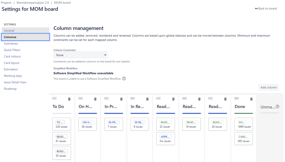

Hello @Sindre Hauglum ,
Can you please post a pic, how your current board columns are configured.
It will helps more to analyze the issue.

This is a multi project board. And I notice that Simplified Work Flow is not in use. I do not know if that is related to this issue.SettingsColumns.PNG
Please place the "ready for production" under the right most column "Done".
once this done, you will be able to see this in burndown charts

Place all green done statuses in right most column.
