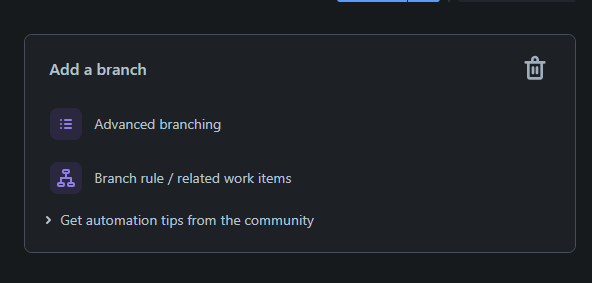

Now I'm stuck on the last part. I don't have the for each function on the branch. This seems like a deal breaker for the whole automation. It seems like I'd have to it for every sprint by hand. Or am I seeing this wrong?
Vishal Biyani
April 16, 2025
@goekce.vardar1
When you click on add a branch, you will see screen like below. Click on Advanced branching and here you can branch on the array of sprints.
goekce.vardar1
April 22, 2025
@Vishal Biyani I don't have this. I don't have Jira cloud and don't see those options. My Jira is very limited I think.
