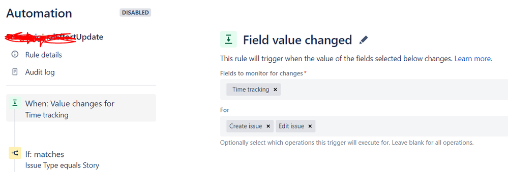

Vishal Biyani
October 8, 2021
@Faizan Iftikhar
You can write an automation rule by checking if Value changes for Time tracking. After that you can put the numeric condition to compare if total time is > then your threshold, then use New Action to trigger Email action.
I haven't tried this... but this approach should work.

Vishal Biyani
October 8, 2021
Let me try to elaborate a bit more. There is No need for JQL, if you are interested in Time tracking changes.
When the rule checks for "Value Changes for Time Tracking" it will get fired when time is logged against any issue in project. You can include the event. I had selected "Create Issue" and "Edit Issue"
see the right side of the screenshot.
After that you can use smart values like {{issue.aggregatetimeoriginalestimate}} to check for instance i can say
if {{issue.aggregatetimeoriginalestimate}} > 40*3600 Then trigger email
Hope this helps.
[Note: 40*3600 means 40 hours since in my instance time is set to minutes granularity]

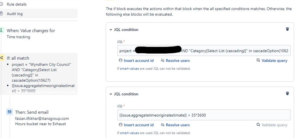

Faizan Iftikhar
October 8, 2021
Thanks @Vishal Biyani  for extended help.
I have added one extra condition as it works for overall project hours so restricted on a particular category PFB snapshot.
If you can validate that would Great help !!
Thanks in Advance!!
Vishal Biyani
October 9, 2021
Looks good. Just make sure that default unit of time tracking is minutes. Jira admin can check this
settings -> Issues -> Issue Features -> Time Tracking
if this is set to hours then change the division from 3600 to 60.

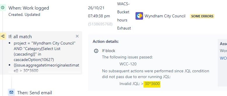

Faizan Iftikhar
October 27, 2021
Hi @Vishal Biyani
hope you doing good, can you please help or Any one please.
Trigger was working fine before but after minor tweaks it stop working even after revert with previous configurations, here is some details:
- Sending email every time when condition meets but now not working and giving error mentioned below

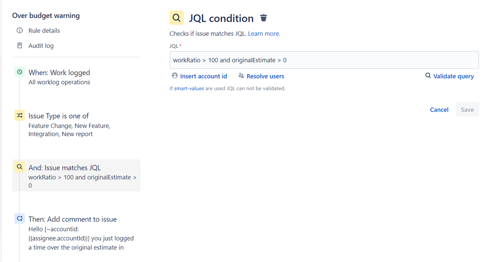

Alexey
October 8, 2021
I have a rule to warn if overbudget occurred, you can play with the work ratio to meet the needed threshold. And the rule runs every time anyone is logging time or like mentioned above to use 'scheduled' trigger with CRON expression
Faizan Iftikhar
October 8, 2021
Hi @Alexey  would you please clarify what work ratio? Is 100 representing hours restriction?
Alexey
October 8, 2021
@Faizan Iftikhar yes, it's % of the logged time, its original estimate vs remaining/logged
Like Faizan Iftikhar likes this

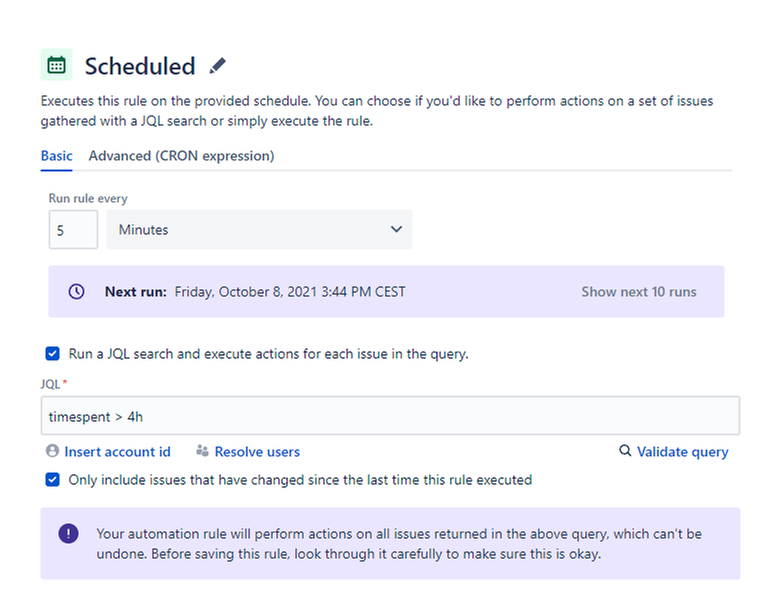

Charlie Misonne
October 8, 2021
You could use the Scheduled trigger and run it every 5min for example.
In the JQL field you can filter for all issue having more than X hours logged. Example for more than 4 hours: timespent > 4h
And as an action you can use the Send Email action

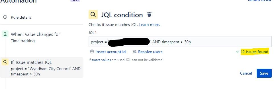

Faizan Iftikhar
October 8, 2021
Hi
Thankyou for your reply
Facing issue as in return any ticket that has above 30 hours spent is reporting back. need to know the query name of time logging means work log created so that in return got a proper figure.
Thanks
