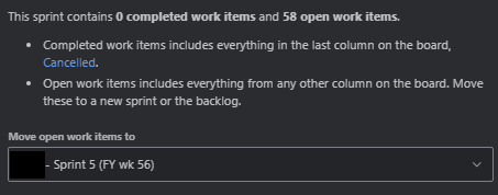

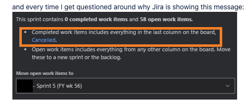

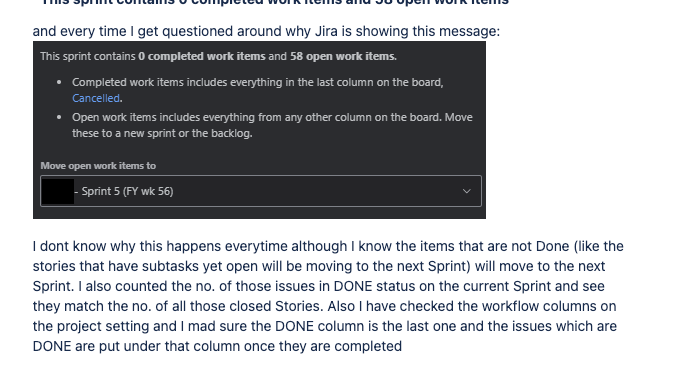

Hi all,
I use a team managed project and I have following following workflow:
1. TO DO: New, Prioritized
2. In Progress: BA, SA, Archi Dev, PBI Dev, Demo
3. Done
now, I have subtasks under each Story issue type that is created and moved by each dev. I have problem when closing my Sprint because although each Story is closed only when the sub-tasks are closed by the devs and that happens before end of Sprint (meaning that no sub-task is open when the relevant Story is closed) but I have the problem of seeing:
"This sprint contains 0 completed work items and 58 open work items"
and every time I get questioned around why Jira is showing this message:
I dont know why this happens everytime although I know the items that are not Done (like the stories that have subtasks yet open will be moving to the next Sprint) will move to the next Sprint. I also counted the no. of those issues in DONE status on the current Sprint and see they match the no. of all those closed Stories. Also I have checked the workflow columns on the project setting and I mad sure the DONE column is the last one and the issues which are DONE are put under that column once they are completed
Your help would be much appreciated.

Hello @Ardalan Sepehri
Looking at your original post I see this:
In the image it says that the last column on your board is "Cancelled", and in your text said you are moving the issues to the DONE column.
Can you show us the Column/Status configuration for your board?
Is the "done" status mapped to the column farthest to the right? Only the issues in the column farthest to the right are considered complete at the end of the sprint.
If you have a column for the Done status and a separate column for the Cancelled status, and the Cancelled column is the one farther to the right, then only the issues where the issue and all its subtasks are in the Cancelled column would be considered complete.
If issues in both the Done and Cancelled statuses should be considered "complete" at the end of the sprint (per your process) then both statuses need to be mapped to the same column - the one farthest to the right on your board.

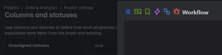

Ardalan Sepehri
July 31, 2025
Hi @Trudy P Claspill , I am addressing you again here as I hope still to find an answer for my problem: Sans titre.jpg
As you see the last column in the right for my board configuraiton is DONE column and I don't understand how I have Cancelled column showing up in the above screenshot I shared in the 1st place? I would appreciate your help! All I need is to change the setting of the board so that once we close the Sprint it doesn't show that misleading message:Capture d’écran 2025-07-28 092213.png

Trudy P Claspill
July 31, 2025
Can you provide a complete screen image of your status/column mapping, please?
Example:
I want to see if there are any unmapped statuses, and see where the Cancelled status is mapped (assuming it exists). I also want to confirm that there is not indication of another column farther to the right by being able to see the "+" button to the right of the last column.
Can you use the "Search work items" option under the Filters menu to search for all issues that are in the Sprint you are trying to close? Check that there are no issues from another project in the sprint. Issues from another project that erroneously got assigned to the sprint would not show up in the board built into the Team Managed project.
Since we are a user community without access to your instance you may want to escalate this to your Jira Admins and ask them to open a support case directly with Atlassian. With your admin's permission Atlassian can be granted access to your instance so that they can look directly at the data to diagnose the problem.

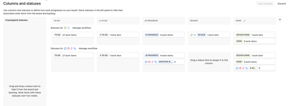

Ardalan Sepehri
July 28, 2025
Hi @pawarsachin84 ,
thanks for the quick reply, however, I am not sure your response could be applied on my case or not because as I explained in my question, all the subtasks are well closed (in the rightmost column before we close the Sprint), here is the screenshot for our columns & statuses setting of the board. As you see here all the Done statuses are applied to all issue type (including sub-task) for moving them to DONE:
so, although we have all those sub-tasks are well mapped to DONE but still I have this issue upon closing my Sprint

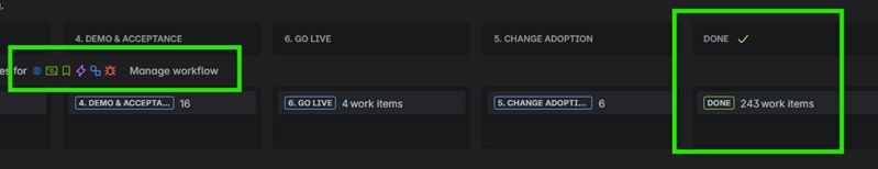

Ardalan Sepehri
July 30, 2025
@pawarsachin84  Thanks for the reply!
My problem is not just closing one Sprint but it happens for all the past and current sprints again and again. here is the screenshot of the most right columns of the board so that you could please help me figuring out what is causing this issue:
