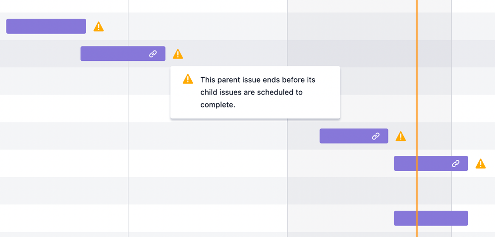

Hi,
 I have found a warning msg "This parent issue ends before its child issues are scheduled to complete." appear in all epic timelines in the roadmap. Not so sure how to make it gone.

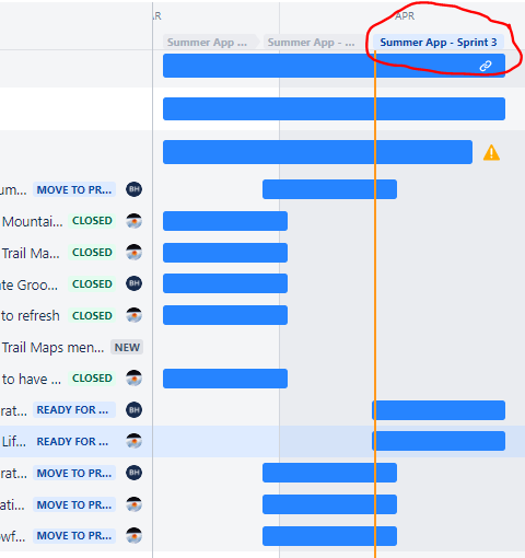

Shailesh Chaskar
April 19, 2022
This issue occurs bcoz ur epic is not linked to sprint 1 as example
Some of the stories/task under the epic are part of sprint 1.
Solution - assign sprint 1 to epic, if sprint 1 is closed then move all done task to next sprint.
Melissa Resutko
April 12, 2022
For me, this issue happens when I add a ticket to a sprint and the sprint end date is after the Epic end date. I have no due dates on epics or tickets, but that sprint end date seems to be the issue.
