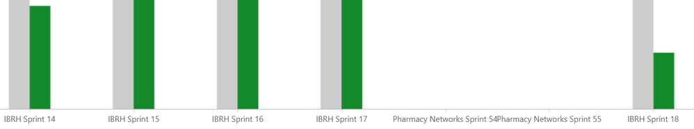

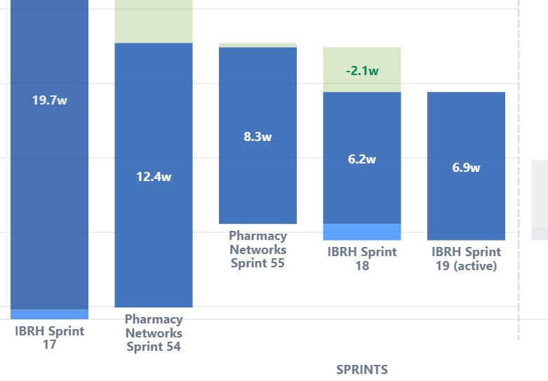

When going over our release burndown and velocity reports we noticed an extra project showing up and we cannot figure out why.
The only overlap between the two projects is a ticket that was created in project A and was assigned a sprint in project B. We would only like to see Project A information in our reports but the one Task that linked the two is completed and in a completed sprint so we cannot remove the sprint on that task to see if that is causing the overlap.
Examples below. Our project is IBRH and project b the unwanted one is Pharmacy Networks.

Check the underlying filter that forms your scrum board - Board settings > general, view and edit the filter.

Thanks for the reply, we actually looked into this and didn't find anything there. Our IBRH project key is PE and the filter is:
project = "Performance Enablement Solutions" AND (component = "IT HUB" OR component is EMPTY) ORDER BY Rank ASC
We should only see the PE project represented here if i'm reading it correctly.
